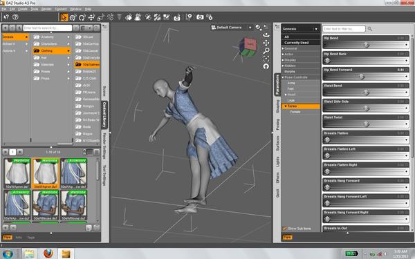

What I find is that, though most of each of these products, (except for the shoes,) load properly on the zero-pose Genesis Female figure,

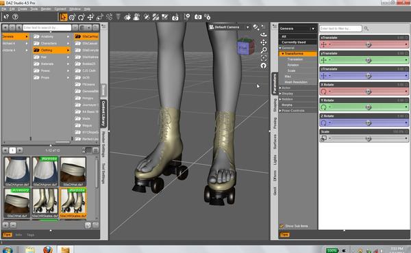

any attempt to pose the figure leads to severe problems. With Carhop and Casual, the shoe items don't load correctly in the first place,

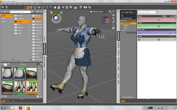

and there are no foot-pose options to help. In all three products, the clothing acts as "non-conforming," and doesn't follow the pose at
all.
Each product does load with smoothing-modifiers enabled, but when the entire clothing ensemble is applied, there are five or six
smoothings going on at once, and the system-drag is a extreme, even on a simple figure-rotate.

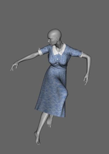

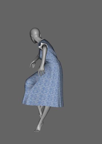

The screenshots tell the tale, with the extreme Genesis Freak shape to radicalize the issue.
Any thoughts?

    Several of the 'problems' are actually features...the problem is, they aren't easy to find where to control them.
    DS4.x doesn't really 'do handles' any longer, so the movement controls for things like skirts may be hard to find, and with the first pic posted, it looks like you need to find them. They'll probably be under the skirt's Parameters, somewhere (don't have that set, so I don't know specifically where...). The fact that there are movement controls and that the skirt isn't controlled/following the legs is great...because that means it's not going to suffer the 'plastic wrap' look that happens when those controls/extras bones aren't present.
    The foot/shoes...now that's a different story...there should be at least an initial pose, somewhere...either that, or there's a specific procedure to follow.

    Skirts and dresses have usually "ghost bones" that let you pose that part of the clothing item separate from the figure. This is desirable not a problem. You want to be able to control how the dress moves to simulate wind and other forces. Simply expand the dress on the scene tab, go down to the hip area, etc. and find the various "ghost bones" and pose them appropriately to achieve the desired results.

    And yes, on the shoes, skates, etc. there is probably a "foot pose" file that needs to be applied before the shoes are loaded.

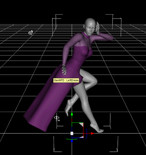

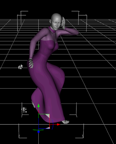

    Here's a before/after on the Morphing Fantasy Dress. :)

    The shoe "pose" isn't anywhere i could find. I knew to look, and did; in other shoe products it's subfoldered behind the main product listed, and is called "pose," in every V5 or Genesis-case, there's a png. of the pose to go with it.
    With these sets, there's only "materials," and no pose, and no png. unless it's hiding in some completely unusual place.
    THe MFD is a good example of this. Anyone who's used it will know the MFD skirt doesn't move with the legs, you have to manually pose it.

    The shoe pose for 50s Casual female is in the Genesis/Poses/50sCasual folder, rather than in the Genesis/Clothing/50sCasual folder. (I just copied it over, once I realized what was happening, because I'd never remember it in the Poses folder.)
    That said, be warned that the shoe pose for 50s Casual female does NOT work the way shoe poses work for other similar shoes. As far as we've been able to determine, the shoe is actually fitted to the shin, rather than the foot. Once the foot is positioned by the foot pose, you absolutely positively cannot touch the foot again; you have to pose the leg instead. If you move the foot, it detaches the foot from the shoe, and then you have to figure out how to make it work properly again. (Another person and I tried to make the point to DAZ support that they had, quite literally, no other shoe of that type in the store that worked that way, but it didn't succeed.)
    The skates for 50s Carhop and the boot for the Onyx for Genesis Female outfit have the same issue. Once the skate or boot is fitted to Genesis, you need to hide the foot and move only the shin; otherwise those shoes don't even come close to working properly. In the case of the skates, at least, the argument can reasonably be made that the foot and ankle really couldn't move much in that type of shoe. The argument makes no sense with the Onyx boot or 50s Casual shoes, but as I say, we weren't able to persuade DAZ support of our case.
