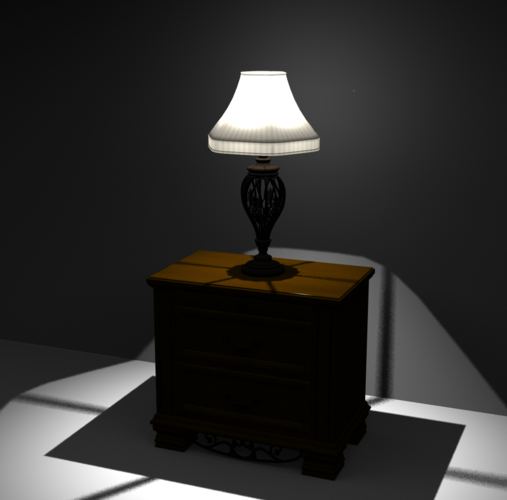

I did this render (WARNING: NO NUDITY!!! OMG! does that mean you won't look?)
http://wancow.deviantart.com/art/room-for-two-348644476

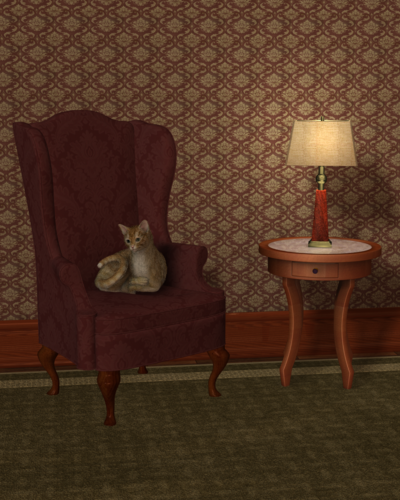

Anyway, I'm hoping someone could clue me into what kind of settings I need to get the lamp shades to look more like this:
http://pnn32.deviantart.com/art/Octane-Mesh-light-and-Transmission-material-344553128
The bulbs in the lamps have UberArea light applied...
I tried applying transluscency and 90% opacity to the lamp shades, but I couldn't get them to pass light through them and become illuminated.

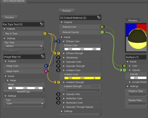

  • wancowwancow Posts: 2,708
    This is where I'm at at the moment...
    This is the very first time I've enabled the shader mixer tab... I'm... a little lost :)
    I shouldn't be, but I be a wee bit lost :)
    295 x 643 - 70K
    691 x 554 - 97K

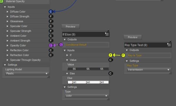

  • Richard HaseltineRichard Haseltine Posts: 111,758
    edited January 2013
    The brick should be testing for Transmission rays, and it gives a true/false output - you need to feed that to an If/The/Else brick (Utility>Control) with the colour for transmission rays (dark, as we want it more transparent) and others (light, so the shade isn't see-through).
    728 x 439 - 36K

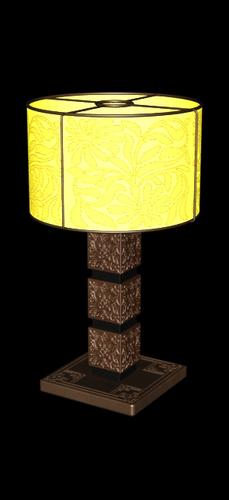

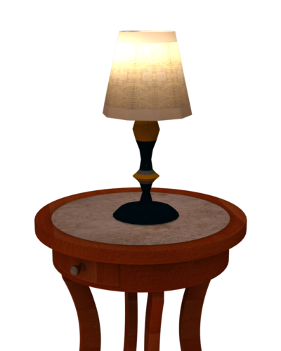

    You can create translucent surfaces using UberSurface shaders. The lamp below was rendered using this technique with an area light thrown in for general illumination.
    897 x 884 - 698K
    Hmmm... interesting... I wonder if Tim Tams are the reason I can't get Marzapan over Christmas anymore... :(
    HOF, can you tell me what setting you used on the UberSurface?
    In the image above, I just turned on Translucency and set it to 40%. The lighting was done using a point light and a spotlight pointing downwards (since the point light alone wasn't giving me the light spread underneath the lamp). The lamp shade texture was used as a translucency map, as well as for the diffuse map.

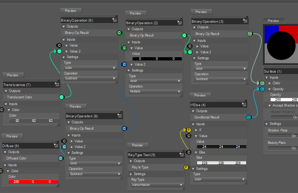

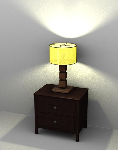

    Managed to get this! Thanks for all the help, everyone... I'll post the two relevant shaders in a bit.
    474 x 603 - 163K

    HoF...yeah, that's what I was talking about...except I've always done it balancing the Diffuse/Translucent numbers. (I need to install that lamp pack that was a freebie a few weeks ago..I thought I had some other lamps installed, but can't find them...this one has reversed normals, it looks like).
    800 x 1000 - 403K
