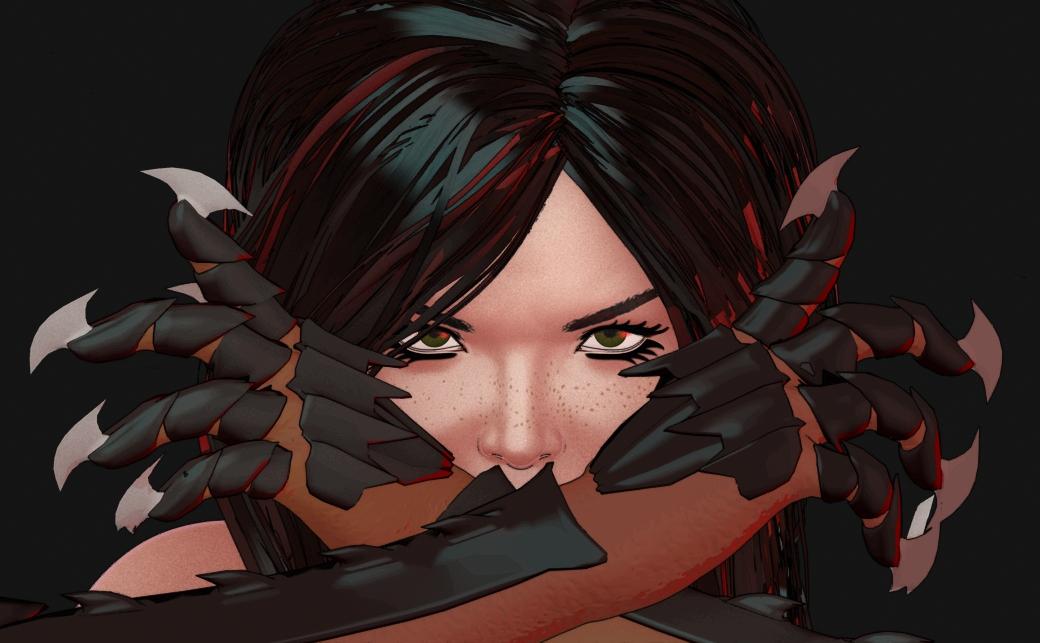

A few months ago, I created my own gloves for a new user contest:
Note that for each segment of the finger, there's an overlap that goes over the knuckles. The Transfer Utility is is making thos overlapping pieces part of the previous segment, because those vertices overlap that segment.

I was really looking for a way out of using the Geometry editor, but after finding the "Select Connected" ability, and read up on painting weights, it wasn't so bad after all.
Here is the updated image. It's doing what I want... but now it helps me see that I am not entirely happy with the mesh... XD
