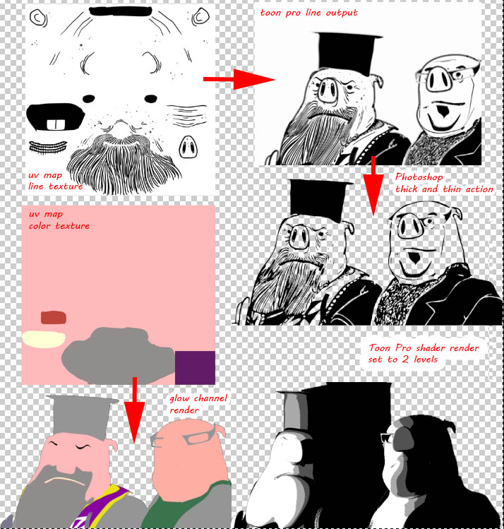

    NASSOS has a special means of rendering and then runs the frames through a Photoshop action he's developed himself, which we can see the result of here which he made for his many-award-winning "Dinner for Few" short film. He might even have sme good notes about it in the thread for that film here
    edited February 2017
    Ahh yes. It appears he's using the UVs to create line textures and Toon Pro... ingenius!
    Post edited by Dartanbeck on
    Using that in combination with your rendering technique should work really nicely!

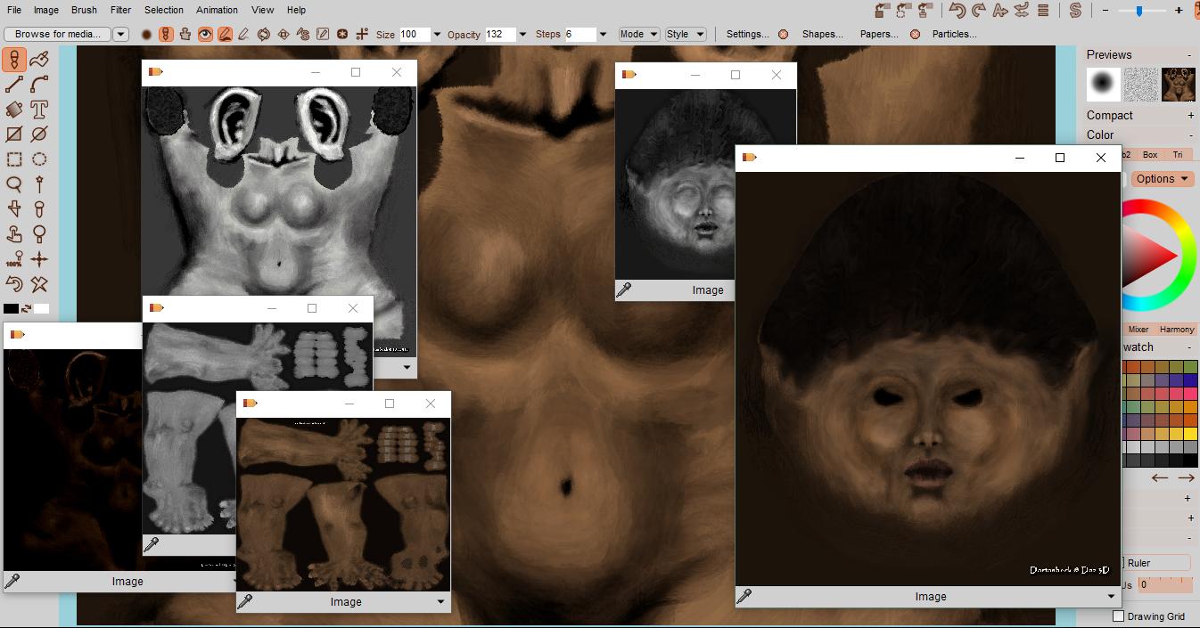

    Here is a sampling of some hand-painted textures I was working on for a "Painted" look. While the total grayscale maps were made for Bump, I also used them as the driver (shader node) of Color Gradients as well, and the really dark color map in the lower left was originally intended for the highlight channel. I didn't like this particular set of maps, but I loved the experiment and will always be continuing to work with such ideas.
    I painted these directly in Howler, which I love for the incredible paint feel I get, but I think my next attempt will begin in Carrara's 3D Paint, then bring those results into Howler for more fun ;)
    1346 x 705 - 782K
