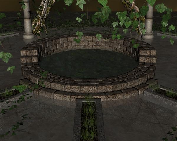

No water in the Celestial Pool I bought from the market place!
Alfhak712Alfhak712 Posts: 94
I don't know if it is me who don't know how to get the water visual in the pool!
Everythings looks ok then I have load the scenery but then taken photos down the pool
no water is showing! I trid to set up spotlights but no help with that!
The water texture are installed corect
In the Content Library I select Full Scene to load up! there are flower in the pots, green leaves
and all looks ok except the water in the pool!
Thanks in advance!

  • NeilV_1NeilV_1 Posts: 442
    The prop is called AC_CelestialFountain and the mat is called Fountain as all of this set is props you are best to expand the whole tree and select all parts before you start to apply the mats (this is how I do it any way) if you have applied the full set preset.
    This is a quick test render in DS3
