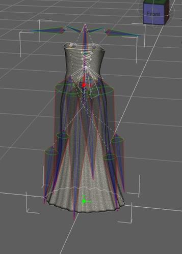

Okay, I think I've figured out a viable means to get V4 dresses to Genesis.
If someone recognizes this dress, I thought I got it from ShareCG, but I can't find it there nor on Renderosity (there's both a V4 and an A4 version, it's called V4_long_dress_04)

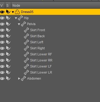

Anyway, it has the best bone settup I've seen for a long dress, and I'm in the process of re-creating that for Genesis.
But there might be an issue in the settup, because the skirt on the original is a single face group affected by one skirt bone, and eight child bones of that skirt.
My question is this: Can I define the skirt as a single face group and use falloff zones to affect motion for the eight child bones or must I define a face group for each of those bones (as I've always seen... I'm hoping not...)?
    You don't need face groups if you don't want them, at least in DS - Poser is a bit fussier, but as long as all of the mesh belongs to a group associated with a bone I think you should be OK. The face groups just enable you to click on the item to select the bone and to hide parts of the item - they aren't functional as far as rigging is concerned.
    The problem you are going to run into is that on a TriAx figure the weights are normalised - the total weight for a vertex on all the rotation maps for a particular axis must be 1. So you are going to have to be very careful, when painting the weight for one of the sub-handles, that you don't zero the weights for others and that you leave enough head room for other bones that will affect that area.

    I see... so basically I need to do something like make use of regions in order to make sure I do this correctly... thanks Richard.
    I'll let you know how it goes. This particular settup for a long dress is the one that seems to work the best... it allows for such amazing movement, I've long wanted to recreate it.
    OH: I forgot to mention: I did NOT auto transferre the Cr2. I exported the thing to OBJ and imported that and used the transfer utility from the OBJ as a prop. Doing it from the Cr2 just deformed the mesh way too much.

    Okay, so I have discovered that the bone structure that the dress has been set up with seems to be impossible with Triax weightmapping...
    I'll have to try something a little different.
    Basically, all the bones for the skirt, including the lower skirt bones area attached to a single bone. I cannot find a way to make that work, since weight mapping for one bone deletes the weight mapping for the adjacent bone...
    So what I have to do is delete the lower skirt bones I've created and redo those so that they are children of the upper skirt bones.
    This is a shame :( Because the thing worked very, very to simulate fluidity...
    If anyone has any suggestions, I'd love to hear them.
