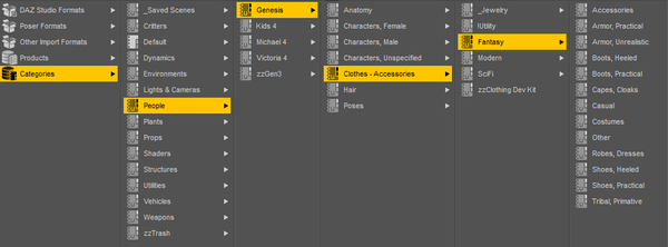

  • adamr001adamr001 Posts: 1,322
    The best advice I can offer, is install only a few items at a time. Categorize them as you go. If you don't do this, you end up with a giant task that's extraordinarily difficult to accomplish.
    The best shortcut you can do is to take Excel or notepad or something and plan out your organization before you get started. Then rely on the Unassigned Category and scanning for new items to give you those few items at a time to process into your new hierarchy.
    Oh another thing that can be handy is to use the "Duplicate" functionality. This is particularly useful for Hairs that have multiple figure compatibility, etc.
    Here's a bit of my OCD that'll give you an idea of what you can structure your data like. You should do something that works for YOU though and not necessarily just copy mine or someone else's structure.
    Kharma said:
    So seeing a post of what you did to organize your content, could you supply a little more info on how to do it? I have just been installing my content by default, and nothing ever shows up in uncategorized except a couple scenes I saved myself. Could you give the steps to achieving this or a link to a tutorial?
    Sure. Give me a bit, I'll post a new thread, but link it in this one.
    edited January 2013
    Actually, give me more than a 'bit'. I'm going to do it up "right" again.
    Probably take me a few days, but to help Kharma's most likely issue, I'll say this right now...
    The key to making Unassigned work for you is to NOT process the metadata queue on startup with DS. When you do that all the data gets automatically categorized and thus cannot be "Unassigned" ever again. So what you do is have DAZ Studio *already running* when you install your content. Then you go to the context menu at the top right of the Content Library tab and select "Scan Known Directories for Files". This will populate the Unassigned category. You can then manually categorize, etc. The next time you start DAZ Studio you will be prompted to import metadata. IF you HAVE NOT not installed anything new since your last scan it is safe to allow this. If you have not finished categorizing your previous installs do NOT allow it do to this as it will remove the items from Unassigned. In this case, your only option to get the default Metadata back is to use the Content Library Context menu option of "Content Database Maintenance" and select the "Re-import Metadata" option. Be warned, this will reprocess ALL metadata so it can take quite a bit of time once your install base gets fairly large. I find it faster to just close and re-open DAZ Studio.
    Kharma said:
    yes as far as nothing showing in uncatagorized, but not how to rearrange the content library folders to make more sense as far as where products are
    Here's my default structure, available in a format you can import and use :)
    http://www.daz3d.com/forums/discussion/15192/
