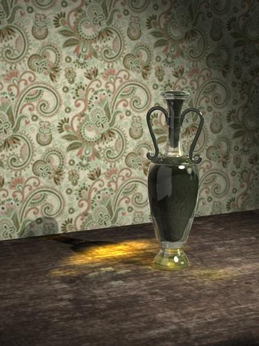

    my pic is max ray trace 2, and shading rate 1, then caustic color turn orange to check.
    (but I understand it is more difficult,to adjust them for naturall and good render ^^;)

    I just tried,, shader mixing light (as same as tutorial , for caustic effect)
    and shader mixing photon camera ( I do not know clearly about each step)
    then understand they can work with daz shader mixture glass (yes I used it ^^;)
    then I ask,, is there any more easy way to make same effect or not @@;?
    glass shader (shader mixture ) not make caustic effect I think without photon camera and caustic light.

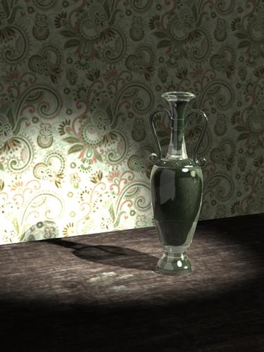

    pic 1 is,, I made the scene by shader mixture light, and caustic camera, and daz glass shader preset.(shader mixture)
    it made caustic color on shade of vase.
    then I made the scene with default daz shader light, and usuall camera with same position,
    it can not make caustic reflected color on shade of vase I think,,@@;
    or is there more simple way by use glass shader and daz default lights?
