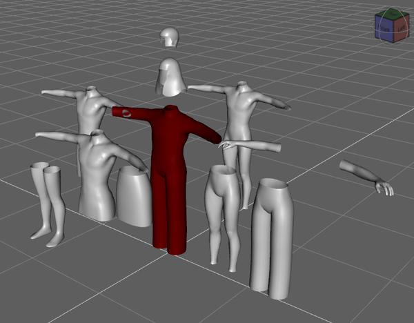

All of the templates contain the full Genesis skeleton, but they contain different mesh (see pic), each has a basic WM designed for that clothing type, which only exists on areas with mesh. The idea is that you use them on general clothing types to get a basic "rig" that works so-so when fitted to Genesis, you are then meant to give the WM a "cleanup" so it works better with your mesh. The draw-back to this is when you convert more elaborate clothing as the templates weren't designed for that, this is where you need to learn TriAx rigging, as you will have to add bones, adjust face groups and paint weights to get the converted clothing to work properly with Genesis.
