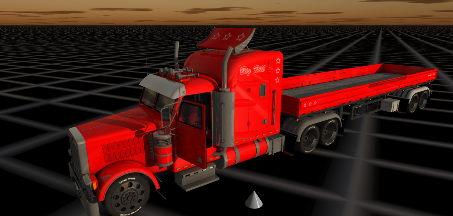

    this the ds version of big bill trailer
    had to tweak the min z rotation for the doors to open outward.  trailor 'fit to' bill.  big wheels keep on turnin, proud mary keep on .. truckin
