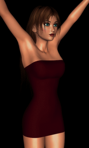

in the few dresses i made and some dresses/shirts i studied,
the CollarBend morph or the geometry of the clothes itself pulls
the dress/shirt away from the character. which is a way to avoid poke-through.
but for Aiko's bodycon dress i want to avoid this
so i'll split the CollarBend morph in 4 or 5 morphs

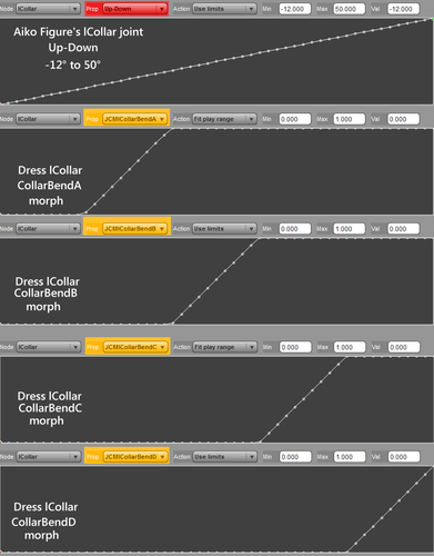

i read a bit about ERCs on this web site ( http://www.atlantis23.com/erc_download.html )
and here's how i'll probably implement the 4-phase CollarBend
in the dress's "BODY node" a constant value of 1, which i should probably hide
valueParm PBMmcjone
name PBMmcjone
initValue 1.00
hidden 0
forceLimits 1
min 0
max 2
trackingScale 0.01
keys
static 0
k 0 1.00
interpStyleLocked 0
in the Collars and the chest actors i have 4 morphs
targetGeom JCMlCollarBendA
name JCMlCollarBendA
forceLimits 1
min 0
max 1
valueOpDeltaAdd
Figure
lCollar:1
zrot
deltaAddDelta 0.080000
targetGeom JCMlCollarBendB
forceLimits 1
min 0
max 1
valueOpDeltaAdd
Figure
lCollar:1
zrot
valueOpDeltaAdd
Figure
BODY:1
PBMmcjone
deltaAddDelta -1
targetGeom JCMlCollarBendC
forceLimits 1
min 0
max 1
valueOpDeltaAdd
Figure
lCollar:1
zrot
valueOpDeltaAdd
Figure
BODY:1
PBMmcjone
deltaAddDelta -2
targetGeom JCMlCollarBendD
forceLimits 1
min 0
max 1
valueOpDeltaAdd
Figure
lCollar:1
zrot
valueOpDeltaAdd
Figure
BODY:1
PBMmcjone
deltaAddDelta -3
in Fig 1 you can see how each morph-phase is activated one after the other
in animated Fig 2 you can see approximately the intended result
That's simply awesome!
But were do you set the ranges for each morph?
Edit: ah don't need to, clever!
Thanks, casual.
I see what you did there (Slaving the extra morphs to the first morph). That's another way to do a 'stackable' morph. I do wonder how complex the code will get when you need to make adjustment morphs/ERC with more than one axis.
My method is slightly different (and required more steps).
