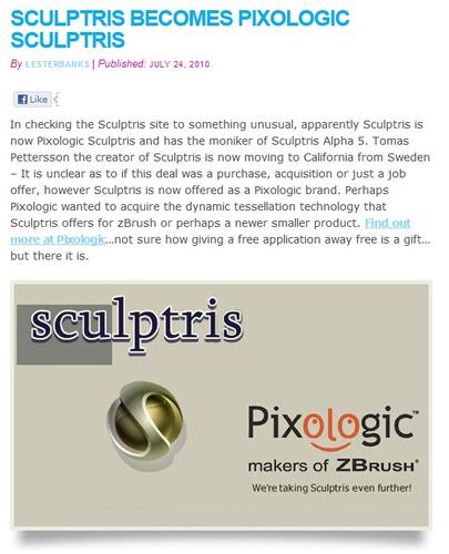

    Sculptris is surprising intuitive and easy to learn. Originally created by a single programmer Tomas Petterson, which he leverage into a job at pixologic. Its set up as a good entry level app.
    574 x 708 - 124K
