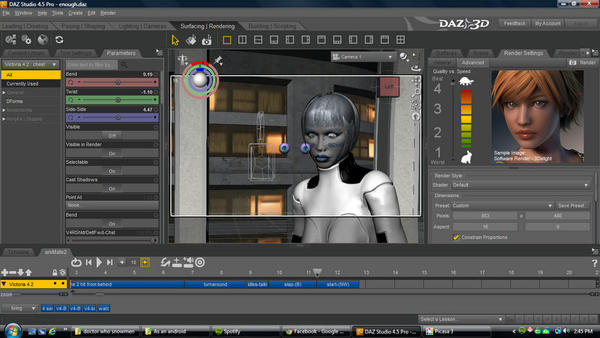

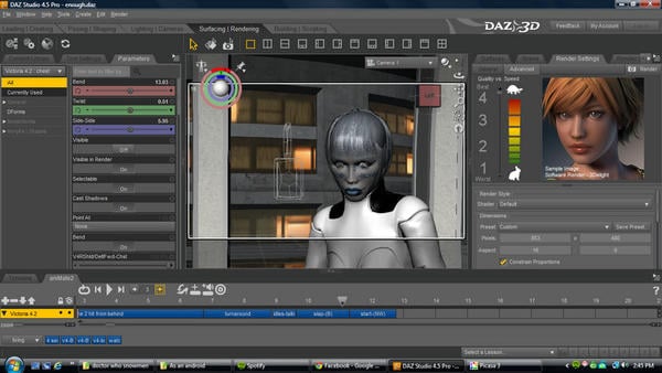

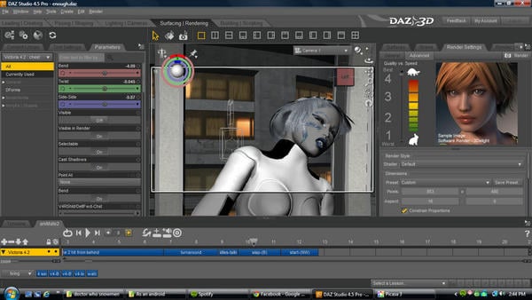

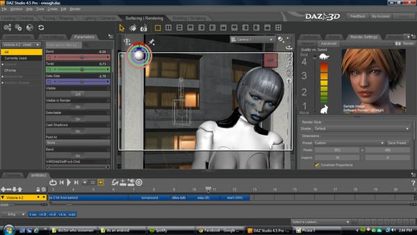

This never seemed to happen before. I first noticed it last week, when I had her turn and start walking. Now, in various scenes, her eyes will bounce back and forth out if her head. If I reduce the smoothness of the transition, it goes away, but then I don't have a smooth transition. This happens in DS3A as well as 4.5.
I had to size these down. I hope the details can be seen. You see that as the head gets to the transition area, her eyes pop out. This absolutely NEVER happened before last week. DS3 and 4 both otherwise work fine and have recently been re-installed.

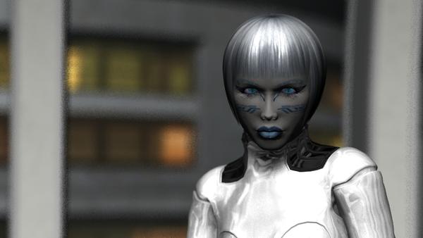

    I rendered the series, but I now have to re-render it because I think the DOF is too shallow. I with the DZ camera worked like a real camera. an Fstop of 44 would normally have deep DOF.

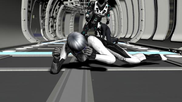

    In this scene, Victoria's jaws end up in the floor with her tongue. Animate wan't used on V4 at all, ever in this scene. That little speck on the floor is probably the tip of her tongue. I had made the other parts invisible but missed it there.
    Again, this only happens with V4. Never with M4 or any other character -- and NEVER before this year, and I've animated V4 a lot.
    853 x 480 - 227K
