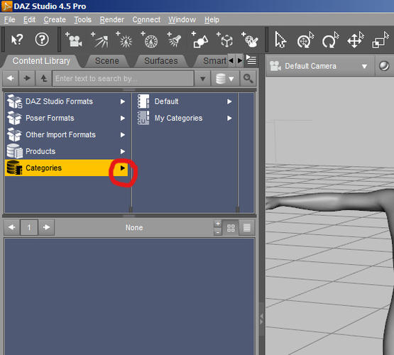

    Is there a triangle next to Categories as shown below, if not, the CMS is not running.

  • Peter WadePeter Wade Posts: 1,700
    Yes, the triangle is there.
    The categories I creaated are shown in the column to the right, but when I click on one of these categories the content pane underneath is empty. When I created the categories I put items in them and yesterday they were displayed in the content pane. I have tried right-clicking the category and selecting "Refresh" but it still doesn't work.

    Is it possible that portion of the pane is closed? Does it actually say "None" as in JimmyC's image?
