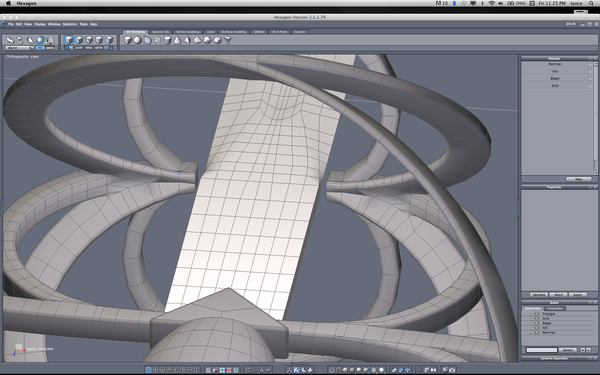

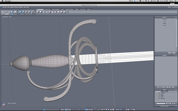

Hello!
These are a couple of screenshots of my first Hex 2.5 model, and I know I made some rookie errors. How do I get rid of some of the interior "leftovers" from where I welded two constructs together? For example, there is a cross section surface inside the blade, as shown in the screenshot.

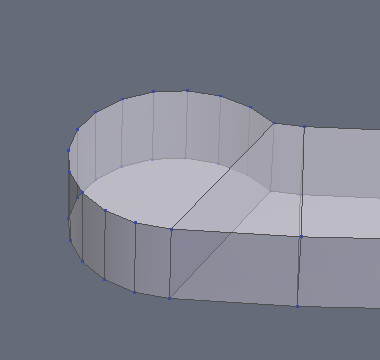

    Follow up question: Apparently "n-gons" (shapes with more than 4 points) are problems? At the tips of the knucklebow and quillons, there are partial cylinders, which means the flat round parts have more than 4 points around the perimeter. Should I try to fix that?
    380 x 360 - 18K
    Short answer...YES!
    Somewhat longer answer...any smoothing or subdivision applied to the surface will turn it very ugly, at the least, if it just doesn't break the mesh.
  • Wee Dangerous JohnWee Dangerous John Posts: 1,605
    Nice sword lexbaird. I see what has gone wrong, when you bridged the two sections together you did it by bridging the faces rather than the lines, this left the original face behind. To fix the problem select a face above the unwanted face and use the hide faces option (bottom right of Hex you have 2 spheres, one has been cut in half - 3rd box from the right), simply hide the face and delete the unwanted one.
    As for your second problem, delete the top face, then bridge the lines which are opposite each other, going by your picture above start at the widest part and work your way up bridging each set of edges one at a time (you could do more than one, but best to be on the safe side).
    Oh, the part known as the blood groove needs a couple more tesselations, one on each side of the shaped bit, so it will keep it shape (the same goes for the cutting edge).
    I like the look of your sword, please post some images when you have finished it :)

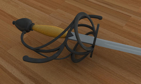

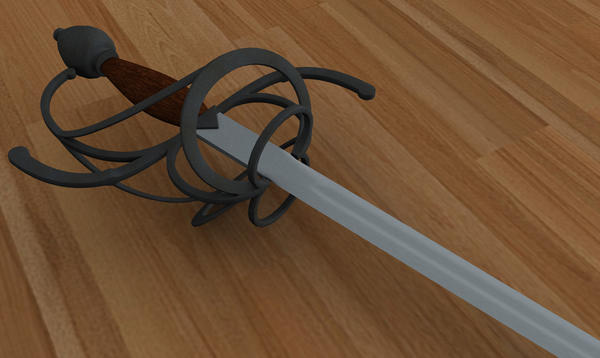

    Test render done in D/S. No bump maps yet.
    1724 x 1028 - 309K
  • DaremoK3DaremoK3 Posts: 798
    Looking good, lexbaird.

  • lexbairdlexbaird Posts: 168
    John,
    I did get it, thanks. Doing the UV for the hilt was a trial! Anyway, thanks for the help, encouragement and advice from all. Here is a render with a bump mapped texture on the ironwork and grip.
    I think I'll call this one done, and work on some companion pieces, maybe a dagger, plus scabbard and belt hanger. When I get the set done, I'll contribute it someplace!
