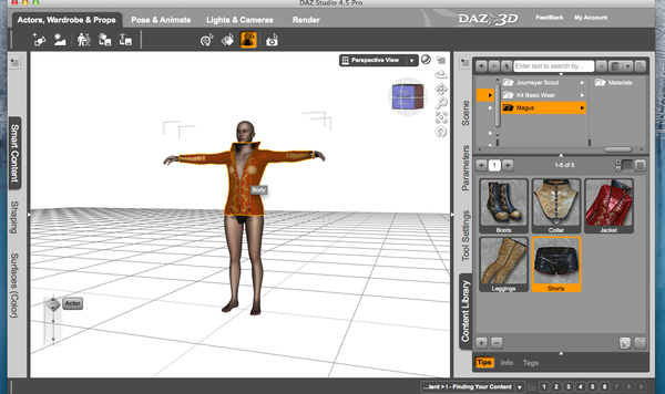

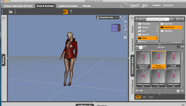

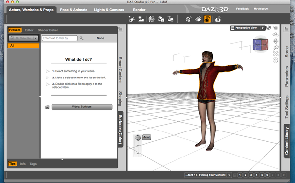

    ok so in the pictures the smart content, the shaping, and the surfaces all have no options no matter what i select in the scene. the figure has clothes on her because i started to try to figure out how to use the right side of the interface but i ran into some problems i cant figure out how to get the clothes to change with the figure if i put a basic female shape on it. i did figure out how to move the clothing with any pose i choose by right clicking and selecting all when in the pose and animate tab, but again i cant figure out how to make the clothes change with the figure so i decided to go back to try and fix the smart content tab etc. so if somebody knows how to fix this problem and if i cant not find a solution my next question would be how do i get clothing to change with the figure of my model. and moreover later i will probably be asking other questions on how to use right side of DAZ 3d. and in regards to the other questions asked me? all I know as of right now is IM running mountain lion and Daz 4.5. Thankyou so much for any help.

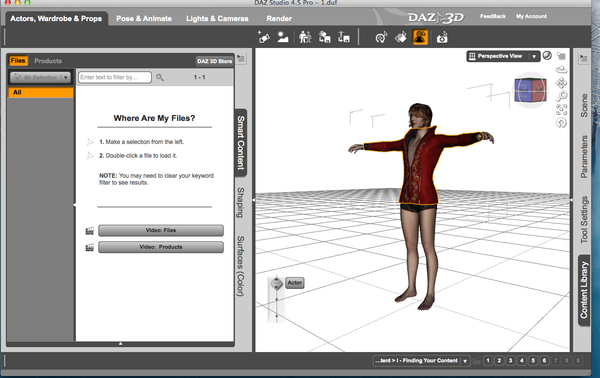

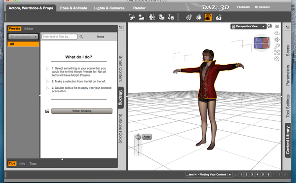

  • chrisjcronechrisjcrone Posts: 0
    it looks like this. any help?

    Not all items have metadata, so won't show up in smart content. Ensure you installed the Genesis starter essentials to get the most out of it to start with.

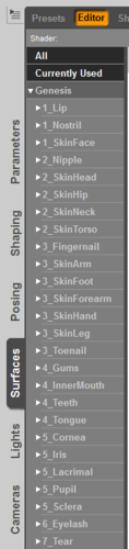

    Secondly the surfaces tab has several options. The one selected in your screenshot was 'Presets' which means it's looking for pre-made material sets specific to the selected surface. If you want to edit them, select 'Editor' from the sidebar and it will display all the properties of the current surface and allow you to edit them to your whims.

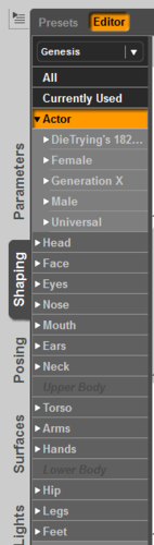

    Lastly, the shaping tab is also listing everything under presets, which you probably don't have at this time. If you want to edit them, you can click editor and alter the various sliders which make up Genesis. Here's some examples to show you where to look.
