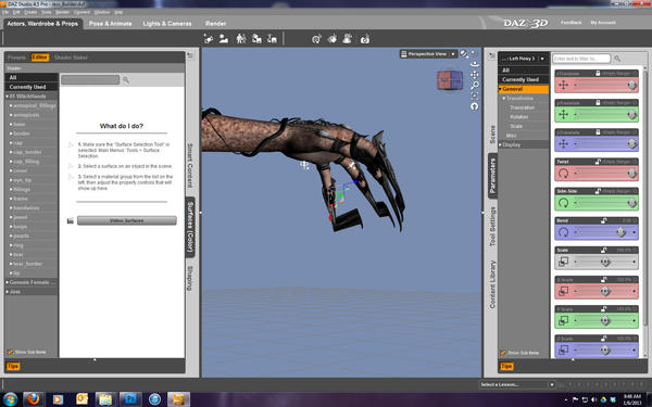

V4 Glove Clothing distort/streching on Genesis with Autofit
So, I've got Y-Stylez's Katey for V4. In particular I'm working with the Witchy Hands clothing/accessory. Autofit seems to convert the glove over pretty well until I create any type of movement that changes the hand location.
As soon as the spatial position of the hand changes I get distortion and stretching in the fingertips of the glove. This distortion looks exactly like the genesis stretching issue with some V4 poses due to xyz translation - except it's on the clothing piece (http://forumarchive.daz3d.com/viewtopic.php?t=170864).
Anybody encountered an issue like this with similar clothing? Or more hopeful: anybody have a fix?
Screenshot attached.
1680 x 1050 - 376K

    Hmm.. well I was able to answer my own question after some fiddling.
    The answer was to set Autofit with Victoria 4 / None - NOT Victoria 4 / Glove.
    The Glove Autofit settings were causing the meshes on the fingertips to go out of wack it seems.
  • matt_e8d6faf681matt_e8d6faf681 Posts: 0
    Well, scratch that. Still an issue. Setting the fit item to none just makes it happen with less ranges of movement but it's still a major issue with any finger movement. :(

  • Richard HaseltineRichard Haseltine Posts: 111,867
    You should be able to use the Group editor and weight painting tool to adjust the rigging - it looks as if the tips of the fingers have been missed, in which case simply selecting the left-behind areas and for the finger 3 bends filling with a weight of 1 should do the job.
    Ok, Richard. Got some pretty good progress. First - This is not a freebie figure.
    I read your armor tutorial and found it extremely helpful. It allowed me to find the exact problem AutoFit is introducing. I looked at the Face Groups on both an autofitted and non-autofitted target. The issue is not that the tips are being left off but that they are being mis-assigned. They attached screen shot I believe shows the problem pretty well.
    So, after some reading of your tutorial and working with the Group Editor and Weight Brush I was able to get the polygons on the tips assigned correctly. And indeed - they now move as one object independent of the other fingers. My remaining issue is in the initial stretch damage caused by the first AutoFit import. Shown below and circled in green is the state of the glove after the first import without any movement. Fixing the Face Placement and Weight Map doesn't correct this issue but does allow for further stretch damage to be avoided.
    I tried using the Transfer Utility to see if I could get it imported without being fit and unfortunately that didn't help.
    Any suggestions? I really appreciate the help so far!
    I was thinking it was probably any issue with the odd "claws". The polygon mis-align was as follows:
    Thumb: OK
    Index: Tips downshifted by a fair margin and mapped to Middle
    Middle: OK
    Ring: Tips mapped to Middle
    Pinky: Tips mapped to Ring
    It was easy to see all the mistakes in the Weight Map and the Group Editor.
