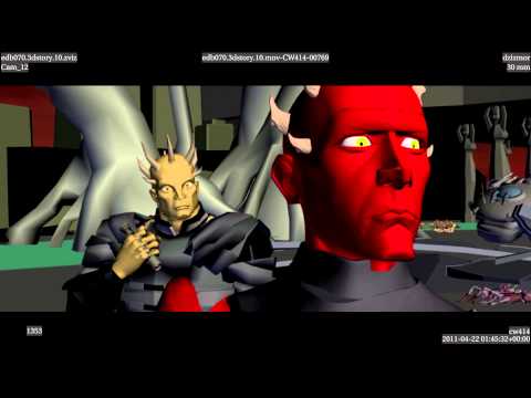

    Oh my... I've never even seen this one yet... by my heroes of the industry!
    Notice how, to bring Darth Maul to life, they've made him more like a Daz3d figure ;)
    While a tear-jerker for me, this final behind-the-scenes helps to show the enormity of the project as they talk about all of the people involved, not only at Skywalker Ranch, but the two companies abroad as well.

    In the Darth Maul video I put up above, Joel mentions some very important tid bits about the realism injected due to subtle eye movements and the like. This stuff is what really drew me into watching the series in the first place - watching the interaction between characters. Their eyes and mouths. How they don't stare at the person they're talking to, but more glance at them and then look away as they explain. Natural subsequent movements. Instantaneous eye positioning. The fact that their visemes don't over-exaggerate every sound in the voice. Watch a person talk once. Then do it again and again. You'll notice that the actual mouth movements don't seem to match the words that closely - especially with area-specific slang or slurs of speech. Most of the movement takes place in the sound - between the tongue and inner mouth. Not so much the lips and jaw.
    So I've noticed that, during dialog, the Clone Wars animators got the tongue right. It's moving just as I've noticed in normal speech patterns of real people.
