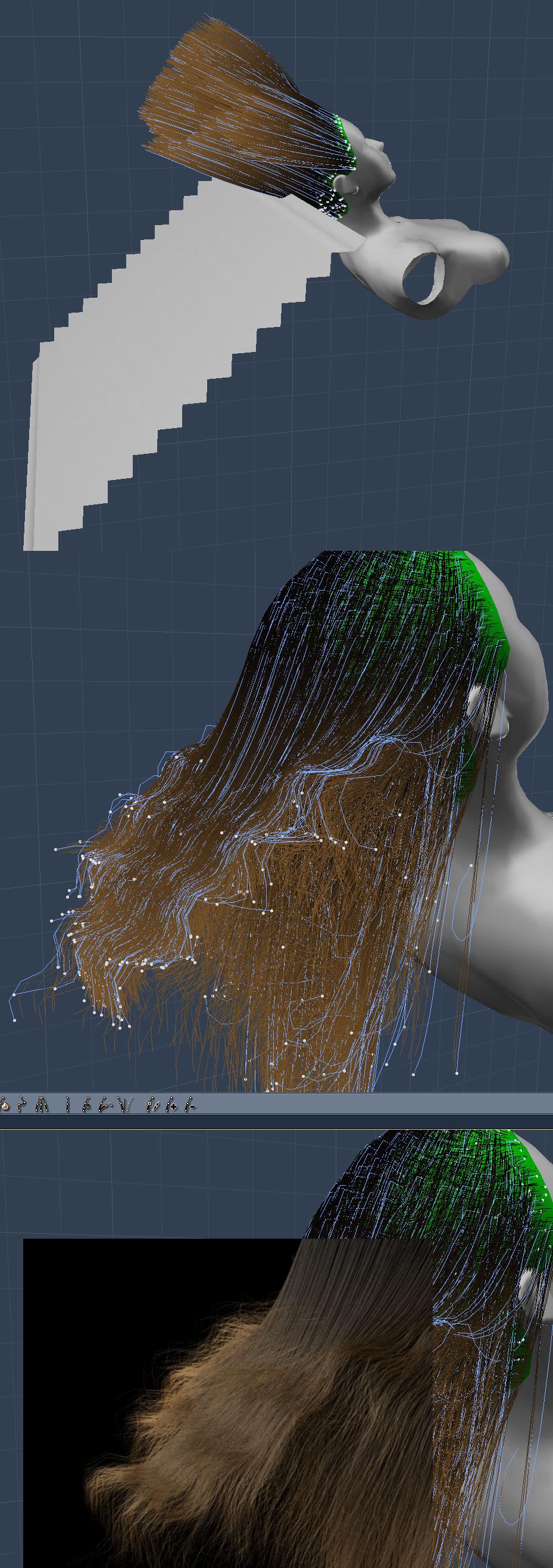

    Dart, that hair looks really great on Rosie. It really is unfortunate that the shader stylers flicker when animated since it's almost impossible to achieve the same styling using only the guide hairs. I'm working on a way to use additional vertex objects in the collider model (since its already present in the hair room) to control the drapping of hair so that we have a little more control over drape styling. Your Rosie curl issue lead me to try a corrugated plane to let the hair drape on. The images below were of a 2 minute proof of concept but I would imagine with the right planning and a bit of work and fiddling you might be able to get a decent Rosie curl result :-)
