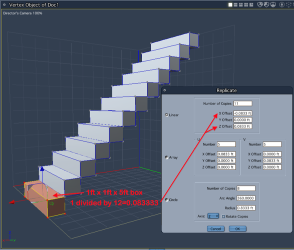

    The units in the Replicate dialog seem to be messed up.
    Divide your desired measurement by 12, and it should work. A 1 foot offset would be entered as 0.083333. In your example, a 0.5 ft offset would be entered as 0.041667.
    899 x 766 - 110K
    Heh. To say the least!
    Thanks, I did figure this out after some head-scratching, beginning with why the X offset defaults to '0.08'. ;-)
    I'm just surprised that this is so obviously broken. Seems like Replicate would be a pretty commonly-used feature, and that this bug would have been reported/fixed long before now.
    Thanks again!!
