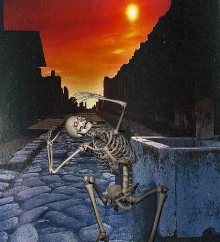

Backdrop not ocupying the whole scene layout
My eyes problem being solved I have the problem with my background picture which doesn't occupy the whole scene space as shown here :
This causes the rendering to have part of my character's feet outside the background which is horrid as you can see here!:
How can I expand the backdrop to occupy the whole scene with or whithout loss of some part of the picture?
Thanks for your help.

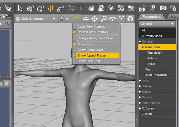

    First of all, turn on the 'Show Aspect Frame', this will show you what will be rendered. You can then alter the frame size in Render Settings to get what you need.

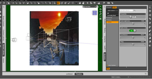

    as far as I can see all you need to do is move your camera position so that the feet are in the production frame.
    I would also ask how are you applying the image to the background as I see a lot of white space

    Hi Jimmy;
    Yes I have the "Show aspect frame " checked, but I wonder if we have Daz 3D same version. Mine is 4.5
    and in the settings render panel, changing the aspect ratio has no effect on the working space and background dimpensions
    fusion. It gives me a full screen in 16/9 aspect ratio with the result that the background perspective is deformed
    and partly cropped.

    I use the background option of the edit menu. And my problem is exactly what you say "as I see a lot of white space"!lol!
    I found a tutorial on the subject here "http://www.amandabb.com/daz-studio-tutorials/daz-studio-tutorial-3-adding-a-background-and-posing-your-character/#comment-2160" , but I think Amanda uses a previous version of DAZ3 D as her second method I tried to use did not work out
    and I did not find the menus she talked about.
    Moving the skeleton would pose another problem as I wish it to look like being seated on the corner of the fountain on the right of the
    image, actually I'm not very satisfied with what I've done for the moment. I must learn to use better the shadows so that it looks seated on the ground by the fountain.; any suggestions and counseling is welcomed as I'm a beginner and have a lot to learn. I think I succeeded to have the feeling of terror expressed by the skeleton but probably the lighting can be bettered too.

    Using the Background option is why this is happening. Something to try apart form compositing them together in GIMP etc
    1: Apply the BKG image to a plane (Create > New Primitive > Plane
    2: Rotate plane on the X axis by 90 degrees
    3: Surfaces Pane apply the image to the diffuse colour channel and to the ambient colour channel.
    4: Set diffuse strength to 0% set ambient strength to 100% Doing this will avoid any scene lighting spilling on the the background.
    5: Also in the Parameters Pane turn OFF Casting Shadows for the plane.
    6: Position Plane to suit.

  • JaderailJaderail Posts: 0
    Step one, Creat a Primitive Plane, then Shape it useing the Prameters Tab settings so it looks to be the same as your Image in width and Hieght. Then using the Pramaters tab rotate the plane as Szark has noted.
    Step two, Open the Surfaces Tab With the plane selected Window>Tabs(Panes)>Surfaces Click the square Icon at the End of the Diffuse setting. Browse to your file and Load it.
    Step three, Do the same for the Ambient section, set settings for the sections as Szark said.
    I hope this helps.

    Thanks Pete and Jaderail! Well that was not obvious at all!!!! Really there is definitely something vital missing in DAZ which is an easy to use and printable manual.with a cross reference index.
    I could have searched for hours!
