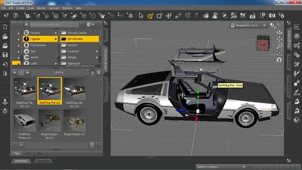

I just bought lwanmtr's Gull Wing item (the Delorean model), and when i loaded it in DS, there were all these black triangles on the car. I know this has something to do with smoothing, but I don't know how to fix this in DAZ.
The car looks fine in Poser.
Can anyone help me out?

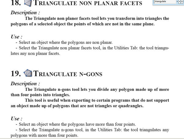

    Seriously, I never realized there was a triangulate function built in. I've been correcting them by doing it in mostly Blender...sometimes, even by hand one or two polys at a time. There's so many features that would be more 'known' with more complete documentation...well, maybe, considering how some major features are just glossed over.
    The Hex manual is very useful I think, it is not up to date, but the information is usually there.
