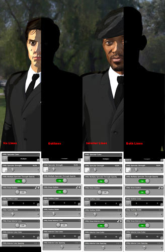

Just an example.
Both Figures and their clothing are using PW Toon shaders with the 'Sazzy Toon' preset.
Everytime I turn on 'Draw Outlines' they are rendered entirely black. The eyes are partly visible, because I did not use the shader for cornea and pupils.
What I also had to realize is that the interior lines don't have any visible effect.
I tried for both lines several thickness settings and different colors always with the same result.
Interior lines do not show up at all and the outlines cover the whole figure in their color (would it have been red, there would be simply a red guy)
For it is the first time I use the shaders extensively I cannot say in which DS version the problem first appeared.
The example is rendered in DS 4.5.1.56 Pro (64bit) with version 1.2 of the PW-Shaders.
