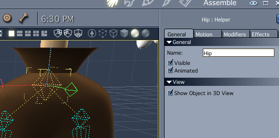

    With Carrara 7.2 you can select the bone and then in the General tab, uncheck the Show Object in 3D view box. (See screen shots.) Is there a similar option in C8.5?
    Just tried to manipulate the other bones in the tree and they don't work unless the other bone is visible.

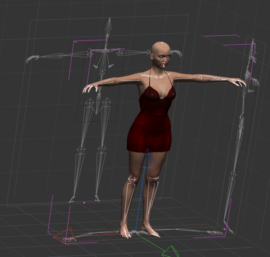

    This perpectual bone visibility is not only on Genesis but also projected on the walls. So ugly and visually cluttering, in any case something that should be set to off by default. The inability to turn it off with one click is extremely upsetting - and novice-ware to say the least.

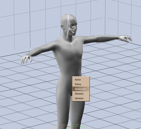

    This has bugged me as well and I just recently found a bit of a workaround and after your post here I looked again and found out a little more.
    When you uncheck the "show in 3d view" for the bones you can no longer see the bone but you also can't select the bone anymore. This can be useful but not for what you want or I want either.
    But try selecting the bone you want hidden and then find the "Display wireframe when attached" box in the Properties Panel/Effects tab and Uncheck it. At first you don't think anything happened but if you wait a bit or click in the 3d view the bone will disappear. The good thing is that if you hover over and then right click on where the bone was , the pop up menu shows up and the hidden bone is in the list. Now you can select the hidden bone and rotate it however you want.
    Also, the popup menu is cleaner looking , there is no longer "wireframe bones" available anymore just the "bone" name. This makes it much cleaner visually to animate.
    The only small problem with this is that you have to uncheck the "Display wireframe when attached" box for each bone individually, mind you only have to do it once so it isn't a big deal . It doesn't take long to do the whole skeleton. I hope you guys find this useful because I know I do

    Here is a screen grab in Carrara with most of the bones "hidden" using the "Display bones when attached" box is unchecked. Notice how clean the right click popup menu is and that the hidden bones are still easily selectable. I know this will make animating a lot easier for us Carraraites.:-)
