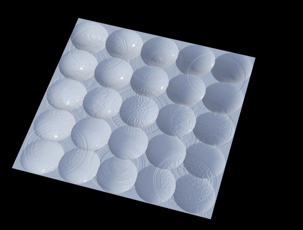

I made an object and textured it. (see the first picture)
The object was made of a few different objects -  mainly half spheres attached to a plane. It also had a cone, and also a 'ladder" shape that sat on the plane.
I textured the different bits. I made the camera 150 mill to reduce distortion and set it directly above the mesh.

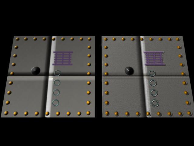

    I think you were applying the bump map with too little bump dialed up, I think the differences are far less than your examples would indicate. I downloaded your textures and set a higher bump level and the results are much closer (normal on left, bump on right). You are correct that there are more artifacts on the smooth surface due to the way you generated the maps. Notice that the "ladder" looks flat on the normal version while it shows depth with the bump map.
    640 x 480 - 22K

    Below image: Mesh

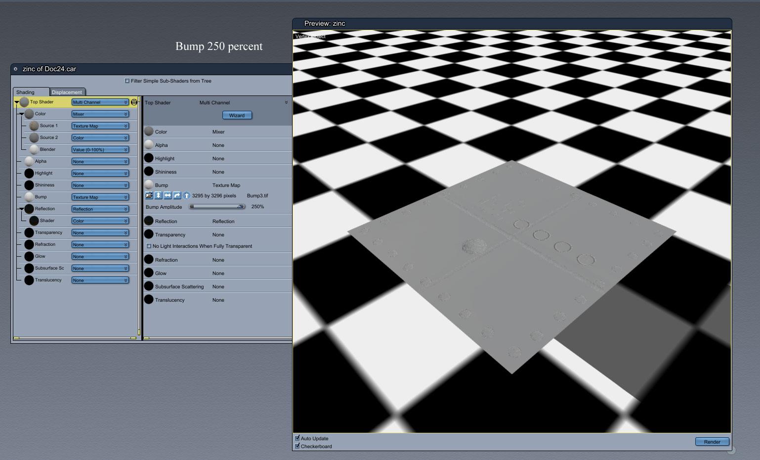

    Thanks for trying that PhilW, that's why I uploaded the textures as well :)
    I was using Bump at Max which was 250 percent.
    Best to compare without the texture maps though I think.
    Cheers !
    1538 x 930 - 173K
    To my eye, for the sloped parts, the Normal map is a winner.
    Cheers from here !

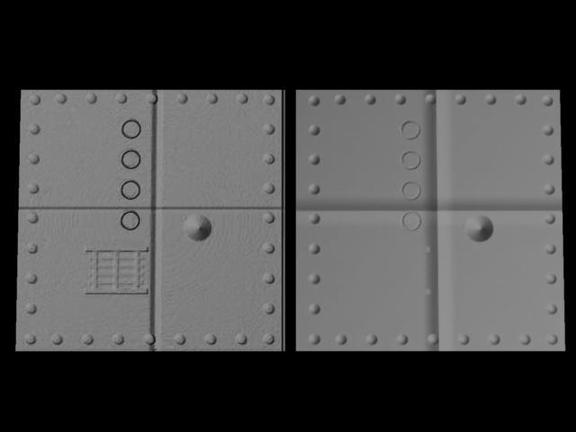

    Head Wax suggested to compare without the texture map (bump on the left this time):
    P.S. It was stated that bump can go up to 250, that is as far as the slider will go, but if you type in a value, it will go higher.
    640 x 480 - 18K

    Nice  render PhilW, thanks. And yes it was about the software, you are correct!

    Interesting the different result PhilW and I got, I wonder if it's because my renders are oblique and Phil's are more full frontal?

    I think I just increased the level of bump so that it better matched the normal map one.
