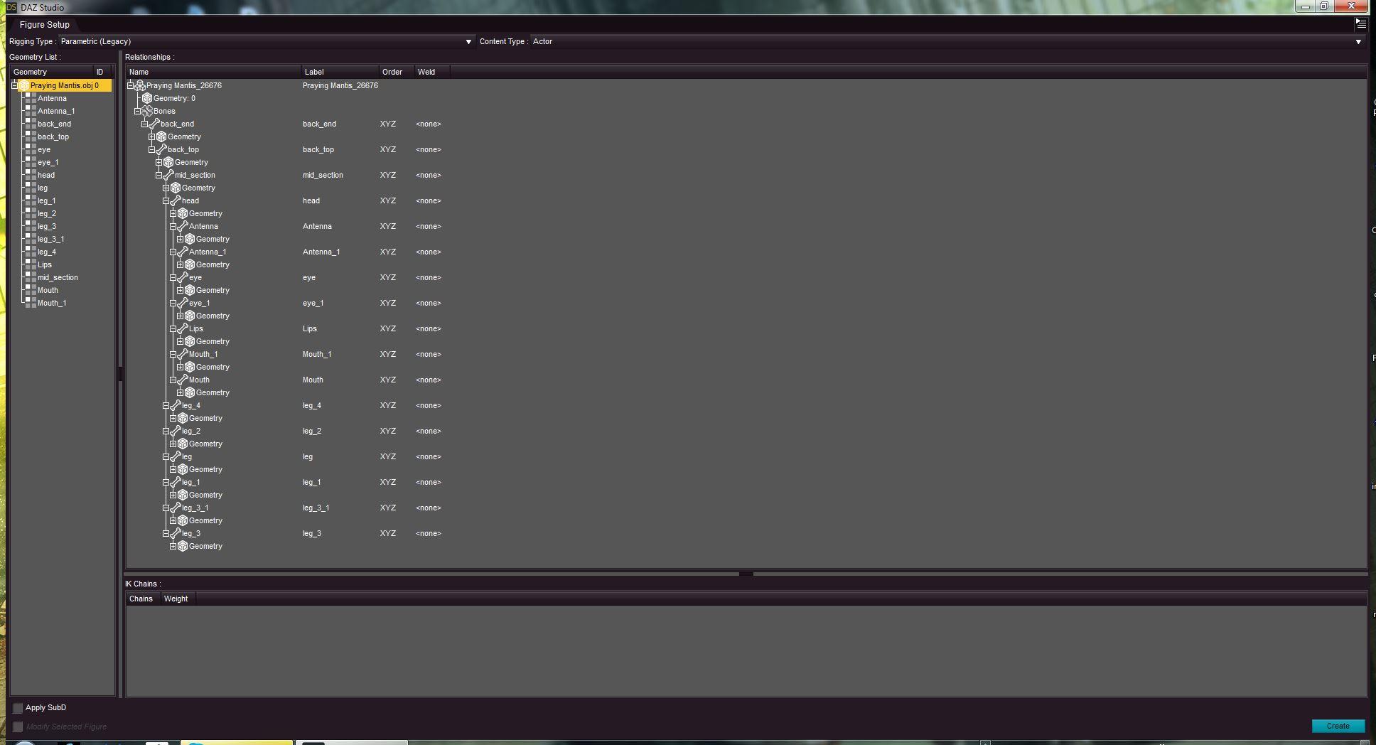

  • in pictures how I would do it
    I will try to next post embed and explain each step

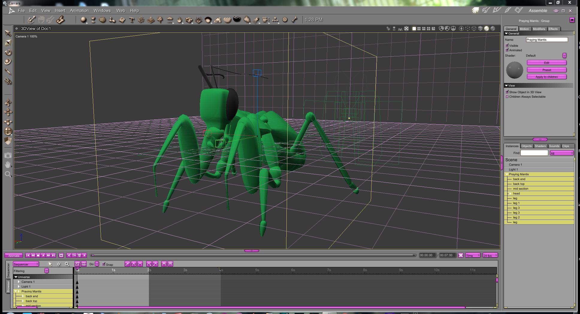

    a Carrara example figure with named body parts I exported as an obj
    loaded geometry on left side adnd dragged into right and dragged each body part into a heirarchy tree then pressed create

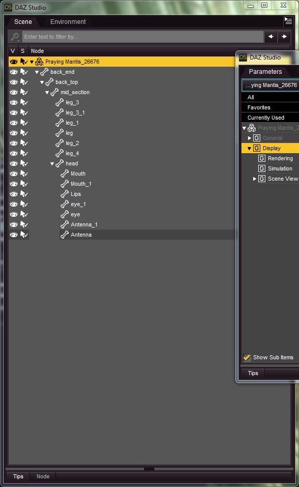

    what I get in DAZ studio scene tab above viewport with bones coloured and made visible below

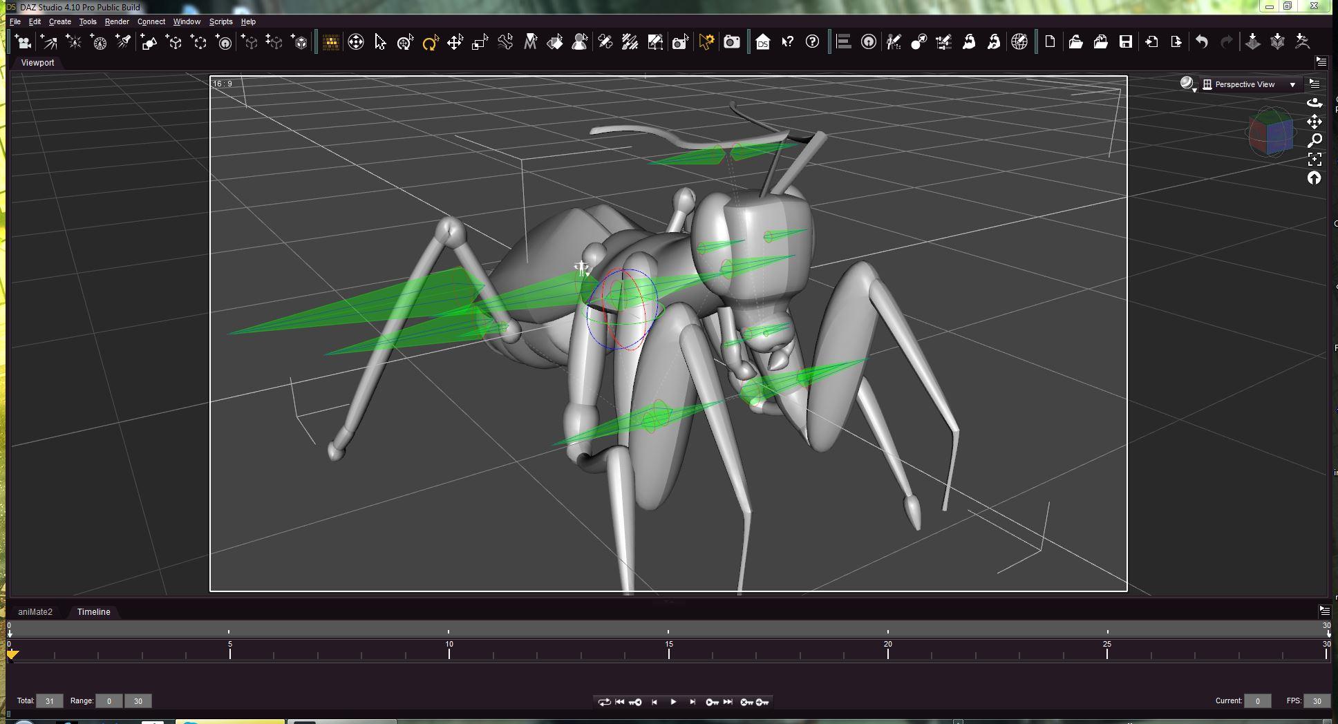

    then I click the little bowtie icon and bring up bone tool
    rightclick

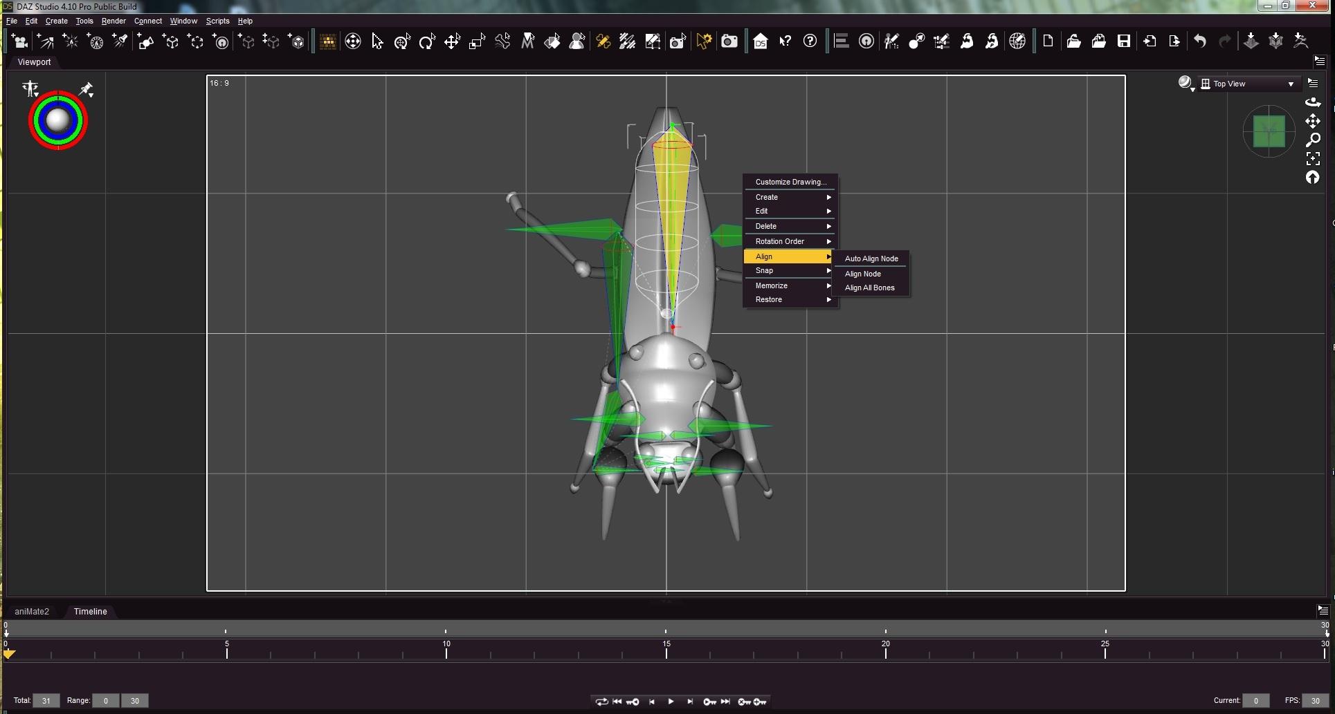

    move the minsicule red and green arrows on a bone to match the body part and align each bone and click memorise rigging
  • WendyLuvsCatzWendyLuvsCatz Posts: 41,507
    edited December 2017
    once you have moved all the bones and memorised rigging you can go to edit, rigging, convert to weightmapping and choose general

    I also saw these auto aling node and snap bone ends settings if you activate them in the joint editor even placing the bones becomes much easier because the bones in the chain following while you edit the placement of the others.
