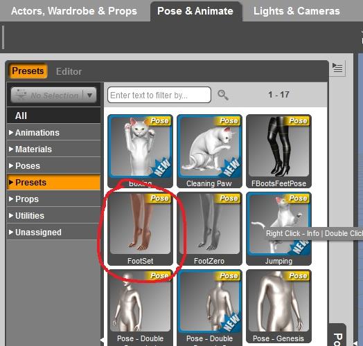

    with the character selected (not the shoes) go into the poses and animation tab, under presets should be a pose for feet that fixes wearing high heels. you might have to re-apply it after any other preset pose to make things look right.
    524 x 500 - 87K

    actually I'm not positive where I got the foot preset from, I assumed it came with Genesis, might not have though, as I did purchase a few high heeled boots for Vicky, but it does seem to work with other shoes,
    Which tab does it show up in? It may be worth Kharma doing a search in that tab with the word foot. She may have something else that would work for her.

    its in the pic near the top of the thread, its called footset, and its under presets

    From the look of your screenie I would guess it's the pose tab. So if she goes to the pose tab and searches for foot she may find that she has a pose from something else that will work.
    Otherwise she may need to pose the foot manually.
