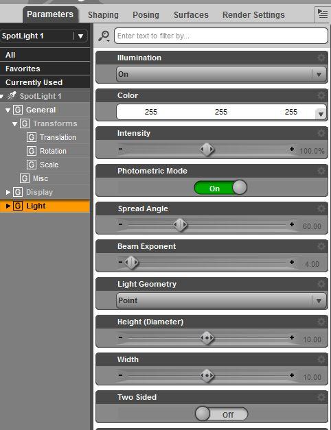

    Don't forget to change the geometry to disc or rectangle etc. units are cm. See attached.
    482 x 627 - 63K

  • I think it works, thank you :)
