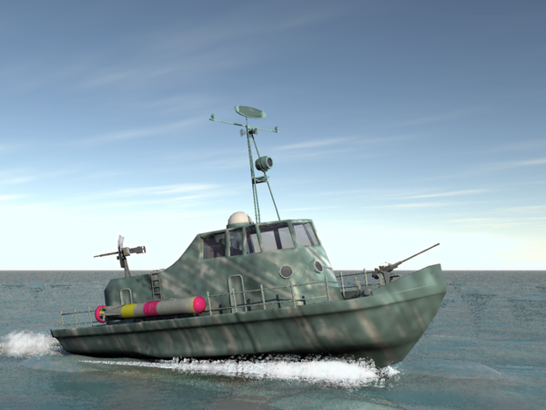

  • RoygeeRoygee Posts: 2,247
    Just so happens i completed a PT Boat model over the weekend and used Spacebones' wakes in the scene. The bibbest problem was to get the shading right - I never succeeded and ended up using water brushes in Gimp to try and correct it. made a pretty crap job of it, so I'm also very interested in getting some advice here.
    Also just discovered a formula which was posted here some years ago. I don' have a clue what to do with it, but here it is for someone who knows what they are doing:)
    y2=(y-0.75)*(y-0.75);
    ax=(y2+0.125)/(y2+0.125/16);
    x=(x*ax)/(1.2+p1);
    x2= (x*x)+(p2/2);
    r2=x2+y2;
    h=4*(x2-0.0625*y2);
    h=(h-r2)*(h-r2);
    dz=((1-exp(-8*y2))*(PI/3+atan(-16*(y-0.75)))*exp(-h)/PI)*(1+p3);
    "parameter 1.... wave angle"
    "parameter 2.... wave head"
    "parameter 3.... wave height"
