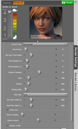

    Try 0.2 for your MAIN render settings (on the render tab) and try 1.00 on the UE2 specific shading rate on the UE2 parameters tab. To clean up the cast shadow in the background I'd need to know what the pixel samples on your main render settings tab are.
  • RarethRareth Posts: 1,462
    Pixel samples are 4 for both x and y
    503 x 831 - 84K
  • adamr001adamr001 Posts: 1,322
    My suggestions:
    Lower Ray Trace Depth to 2
    Increase Pixel Samples X/Y to 8
    Lower Shadow Samples to 16
    Lower Shading Rate to 0.20
    Increase Pixel Filter Width X/Y to 8
  • wancowwancow Posts: 2,708
    adamr001 said:
    My suggestions:
    Lower shadow samples the better? thought I read that it was the other way around..
    30 is unnecessarily high.
    ah, I had it maxxed at one point, and it did not seem to make that much of a hit on render times,
