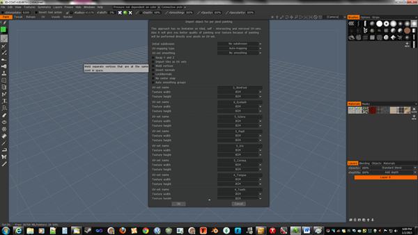

    You have to import the model for pixel painting, make sure there's no additional subdivision, and modify it without adding vertices via the Tweak Tab. I believe the linked video is where I learned that from, so if I forgot anything important, it's probably in there.

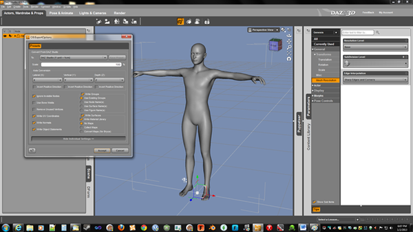

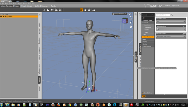

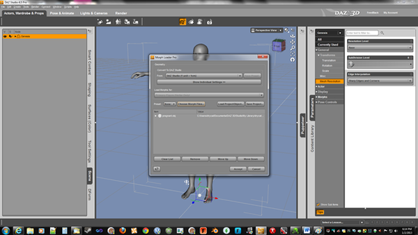

    I am going through and trying out the suggestions in the replies. < --- tyvm for the speedy help! Before I make some attempts, I have attached an archive with my screens in this post of my work flow. ( see attached )
    Now off to make some attempts at getting it right. So far, I tried Importing for Pixel Painting, but it is still exploding the mesh once back into Daz. Still need to fiddle some more.. most likely something simple I am overlooking. On a side note, I found it very simple to Export Genesis, modify it to my hearts content, adding mutiple layers with different morps, and exporting it as a a low poly mesh and then creating a new figure out of it in Daz.
    I can auto rig this new actor, or I can copy from Genesis, but I cannot for the life of me get a a morph fit onto the original Gensis. At first, I thought this might be satisfactory, but I noticed that the new model, even though it has all the original morphs on Gensis, it is absolutely not as polished as the Original Gensis model.
    Would be far better to get the morph import to the original Gensis working :) But, having fun exploring hehe
    Thanks for the help, and hoping someone notices any grevious mistakes I made in my attached workflow ! :)

    Well, that was an adventure. I finally solved my problem. It was such a silly thing in the end. Oh well, always is I guess :lol:
    It turned out to be related to importing the mesh into 3D Coat for pixel painting, but necessary to subdivide the imported mesh.
    This takes alot longer, but maps back out on export from 3D Coat in many different ways, and ultimately into Daz ;p
