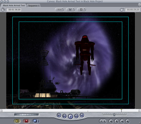

    When I started my Space scene thread, I was willing to post examples. In fact, I had intended to all along. It's not an unreasonable request.
    I agree that compositing is fascinating. It's also a huge time saver. I'm having issues with bandwidth so I can't review the video now, but I did see it before. I think there would be better 3D shots to choose from than one with fairly simple 2D motion graphics. How about the guy walking down the corridor? maybe the moon terrain with the shadow crossing over the old lunar rover? Maybe the ship positioning itself in lunar orbit? Maybe the dolly shot of the camera moving in on the audience?
    This isn't from the video obviously. It's something I'm working on. The sample image is four layers: The stars, the black hole, the ship and the robot. The shot is brief, and not that complicated, but it saved a lot of render time rendering in layers and then compositing.
    I've also just rendered a couple spherical shots so that I can get faster renders yet. Much quicker to wrap a 2D image around your scene than the heavy geometry and complex shaders of the model I'm working with.

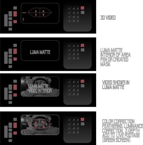

    When compositing video with 3D footage, one normally uses Z-pass (or called Depth Pass). After Effects and other compositing programs do this. After you color correct the video footage and 3D footage, you would want to add a Z-pass from the 3D program or you can do this in After effects.
    Then one would adjust the Luma so one can adjust the chromatics of the green screen to the 3D render. Typically, the luma would be a greyscale or even black and white.
    What that does is it gives the compositor the ability to make the Camera video green screen footage appear as it part of the 3D footage and vice versa.
    The reflection trick is not that difficult to duplicate and is done quite often in architectural renderings. The architect wants to show reflections of existing buildings in the windows and surfaces of the 3D composite. So the architect would make a Z or Depth pass for the 3D composite and integrate it as described above onto the 3D structure or one can make the 3D structure reflect the luminance of the actual "real" buildings.
    Luma tricks, color corrections and z-passes are often how one can integrate fire, explosions or otherwise impossible 'survivable' situations into live video footage and make it appear as if it was part of the actual shot.
    You really didn't think those scenes in Avatar with all those winged creatures and spaceships with people sitting on or in them while flying around was real now did you?
    EDIT: Added a quick show and tell (no specific details - there are tutorials and classes online about ZDepth and Luma - Mattes)
    Pretend the top 2D drawing is the 3D model. I use the very basic (not detailed) steps below to show how to add the video to the 3D rendering.
    790 x 800 - 60K

  • Design AcrobatDesign Acrobat Posts: 459
    edited January 2013
    I edited my post to show how it is basically done.
    If you want to learn After Effects and compositing, take some classes online or at a university.
    Video Co-Pilot, Creative Cow and other places that are After Effect specialists offer many online courses (both free and paid.)
    If you look up z-pass, luma matte, color correction and etc for After Effects, I'm quite sure you'll find many examples to show you how it can be done.
    Actually Joe, I'm doing you a favor by getting you started in the right direction. I don't have the time nor the inclination to keep you entertained.
    You're a smart guy, I'm sure you can find what I told you is accurate and have a play for yourself; assuming that is, you have a compositing program capable of such tasks.

  • The Pencil NeckThe Pencil Neck Posts: 163
    OK. Like everyone has said, this is NOT how they did it.
    How would I do it and use Carrara in the process? Take into consideration that this is NOT what I do so I'm just pulling stuff out of thin air.
    1. The live action would be shot with a green screen so we could get an alpha channel thing so we could lay the animated stuff beneath it. I've never done anything like that but I think that's they way the do it. So that removes the live action of the hand.
    At the same time, I'd get a separate head shot and save that down as an AVI.
    2. I'd create the "control pad" stuff in Photoshop. This would be several different versions of the panel with an all dark version, buttons lit versions.
    3. I'd place a plane (or some sort of surface) in Carrara at the same angle as we want the control panel.
    4. To simulate key clicks or whatever, I would automate the control pad texture by adding keyframes where the the texture would change from one control pad version to the appropriate next keypad version.
    5. Finally, to add the reflection, I would add a second layer on the shader for the control pad. This would overlay the control pad stuff and would be the AVI of the live action head.
    At least, that's how I'd try to do it. I didn't go back and watch the video again but I think that covers the basics.
