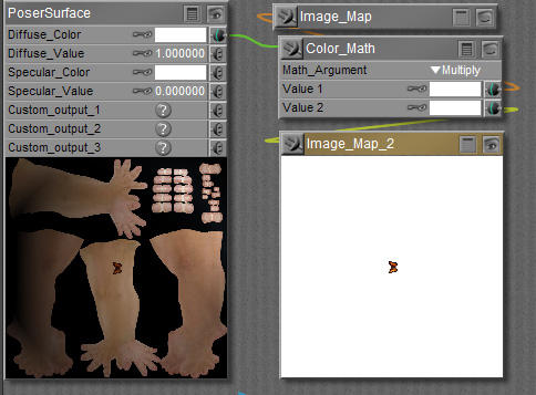

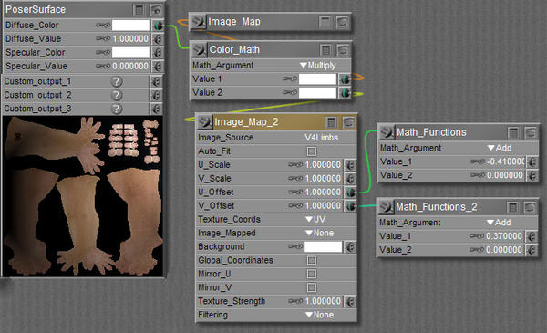

    I use a color_math node and adjust position with U and V if needed.
    It will take a png or jpg, the multiply drops white

    Thank you for responding!
    So what would I use with a transparent background png? Setting it to multiply seems to result in in the overlay not showing up at all with the above settings.
  • MedzinMedzin Posts: 337
    It should work with PNG, I just double check to make sure. Maybe the source of PNG makes difference, like some programs pre-multiply alpha or interlace different
