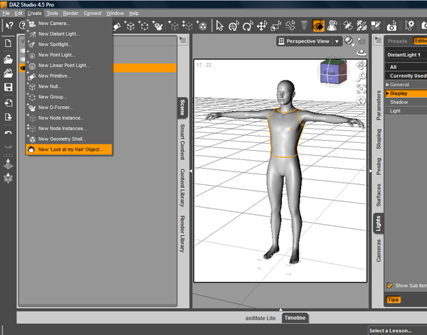

    The Problem I'm having is trying to find the plugin. It was installed and it's activated but I can't find it. Where is this Plugin listed?
  • Alessandro MastronardiAlessandro Mastronardi Posts: 2,659
    Hi, it is in Studio menu Create->New "Look at my Hair" object.

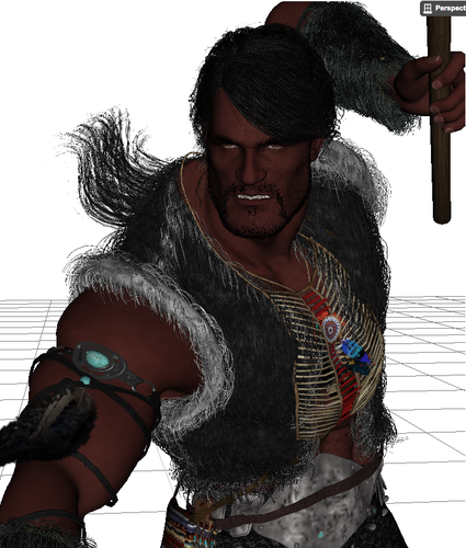

  • Jake_35533Jake_35533 Posts: 242
    wjamband said:
    Thanks for the reply and assist but I already figured it out. Wil play with it tomorow and see how it compares to hair engines of C4d or Maya or even Carrara. If it is at least as good as Carrara then it will be woirth having. It looks like it is very complicated to use and that is not good but like I said I will play with it tomorrow and see.

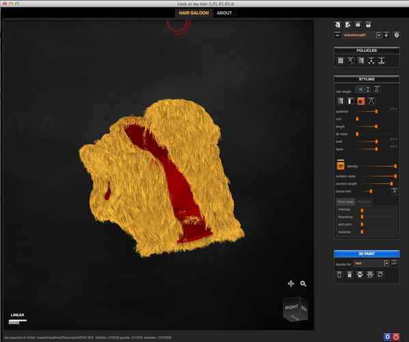

    LAMH is great and seems to be working without any problems with me. The only issue is that I need the hair in .obj format to render in LuxRender. Sometimes the hair (on objects) comes out thin (not dense) even though I set it to full density.
    See the vest in LAMH and the Vest in DS? The .obj fur on the vest is far less dense then that in LAMH. The armbands have the right density though. Is anyone else having this problem?
    718 x 844 - 668K
    1358 x 1136 - 831K
    Hi Jake, I'm glad to hear you're enjoying LAMH.

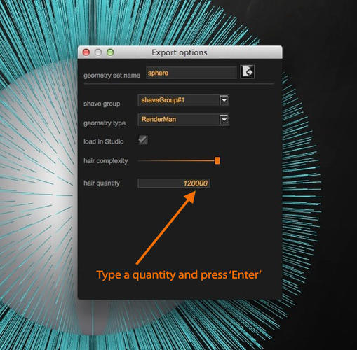

    The hair density slider used in LAMH is only affecting the hair preview: so it won't account for exporting hair.
    When you export hair, you need to type the desired amount of hair directly in the "hair quantity" textbox. See attached image, I typed 120000 and pressed ENTER. That will be the total number of hairs that will be exported and rendered in Studio...
    If it's not clear or you need more clarifications please let me know.
    593 x 582 - 112K
    edited January 2013

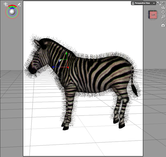

    I did do that (I typed in as many zeros behind the number as possible), I even re-did the hair, exported it to DS (setting everything to the highest setting) and it still came out less dense. See my DS viewport shows the hair as if its just guide hairs (this is the .obj and not render man export), while LAMH shows the hair super dense.
    I tried to make the Zebra with full body hair and it came out with the minimum density of hair (1 million hairs quality). Does the high density hair amount only work with small objects or is there some option I am not clicking on?
    1360 x 1138 - 838K
    1000 x 945 - 422K
    Post edited by Jake_35533 on
    From the second image, where you typed 1000000, I believe you didn't press enter because I see the cursor still active inside the textbox. Am I wrong?
    I think that is what was wrong. Now I know to hit enter before exporting it. Thanks!
    Very good. That's actually a bug that has been addressed in upcoming 1.1 update. Sorry about that.

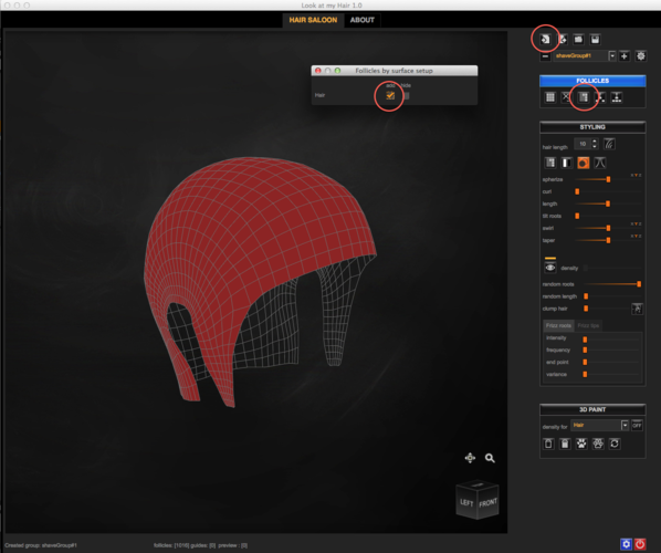

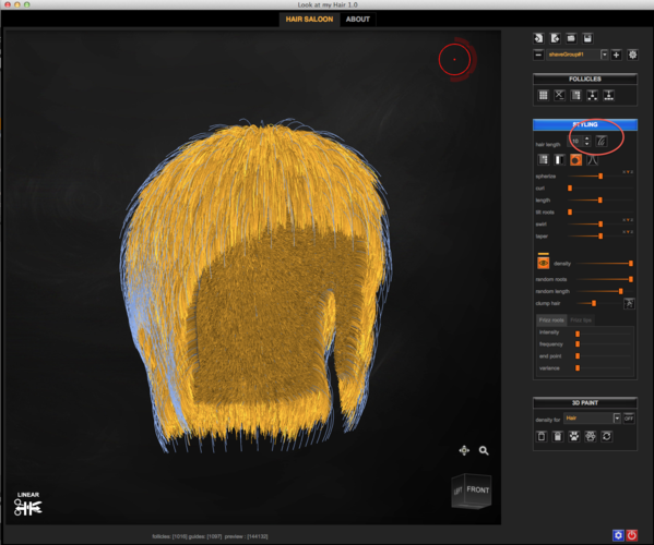

    I have Maya, C4D, Carrara, and 3DS Max and have no clue how to make hair in those programs. I got LAMH and I picked it up in one week. I can imagine a better layout (using tabs, one for importing, the next for selecting, the next for styling, the next for tweaking, and the final for coloring) but its good enough. Since it only does one thing, it can't be "foreign". Its much harder to use Maya and the other programs than LAMH.
    To make the easiest hair quickly, use a hair cap that comes with some of the models you bought in DAZ, like Cesar skin texture for M4, which comes with a cap that you can turn transparent. You can use the mesh to grow hair on instead of the entire character.
    See picture below. Click on the paper with the arrow pointing to it, then click on the icon that has squares dark and light. This opens a box that allows you to select follicles by each surface. Just click add. (You can hide body parts too). Then click the hair button (three strands on it). Then style and put it on you character. That simple.
