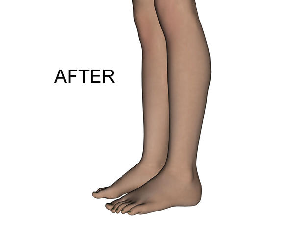

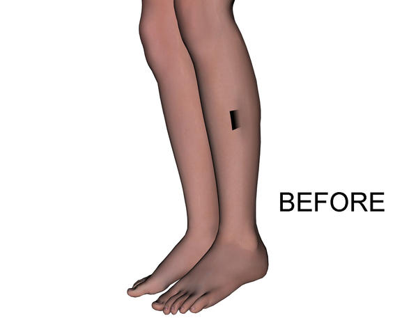

Hi all. Someone gave me this fix and I wanted to pass it on to all you folks who use the Mil Preteen girl still. Many of you have noticed that when you open her up in DS 3.1 or later, there is a screwed up poly on her left shin that leaves a hole in her shin. This will fix that perfectly without having to re-rig the .obj file. Everything will work as it should.
First you will need an editor like notepad ++ or something similar. Once you make the changes, you will want to save the new .obj file where the original one is. Be sure to keep the old one in case you may need it for any characters you may have already, but I have not needed it. I just named the new one the same as the old one and replaced it. It works fine on any new characters I want to make. If you have characters you saved as Daz scene files, they will still have the hole as DS saves geo data with the character. Any new characters you make will be fixed, so you may want to go to your runtime pose folder and redo any you have saved as DS scene files.
I hope this will help you out and I am sure you will love the results of this like I have. No more hiding the shin, or covering it up.
Just open the file blMilGirlPT.obj in a text editor and go down to line 186642 and copy and paste, replace the line
f 26861/62624/16167 26862/62625/16167 26863/62626/16167 26870/62627/16167 26869/62628/16167
with this
f 26861/62624/16167 26862/62625/16167 26870/62627/16167 26869/62628/16167
f 26862/62625/16167 26863/62626/16167 26870/62627/16167
You probably should rename the original file and then save the new version with as blMilGirlPT.obj
Then you need to do the adjacent poly!
Just a few lines above the previous one, also replace this
f 26861/62612/16164 26860/62613/16164 26864/62614/16164 26863/62615/16164 26862/62616/16164
with this
f 26861/62612/16164 26860/62613/16164 26864/62614/16164 26862/62616/16164
f 26864/62614/16164 26863/62615/16164 26862/62616/16164
save the new file as blMilGirlPT.obj...move the original one out to another folder first, don't overwrite it, you may need it later. I just named the original one blMilGirlPTold.obj and put it back with the new one.
Hope this helps all....enjoy!

    Wow...after all this time someone has finally come up with a way of fixing the problem that doesn't require a total rebuild of everything but the mesh.
  • KeryaKerya Posts: 10,943
    Thank you!
    Astoundingly it worked!
    Astoundingly, because I was sure (being me) I will get something borked.
