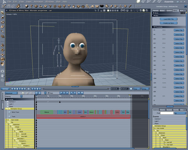

I am unable to find more DMC files. and I am not sure if they can be made.by me. I read the pdf and yes you can create a NLA for a audio file but without a DMC don't you have to build each file to the audio ? any info is good info!
  • 3DAGE3DAGE Posts: 3,320
    Hi Gaffer :)
    With Mimic for Carrara, you can create your own NLA poses for the facial / vocal expressions and associate those with Vocal sounds, so that mimic analyses the sound and creates the lipsync according to how you set up the NLA poses to the sounds.
    You'd normally only need to create the NLA poses once for your character, and then save the file,. and the NLA clips/poses will be saved with it,... the NLA poses can also be saved separately to your clips folder in the browser (or a folder for that character),.
    old pic...
    Hope it helps :)

    No way! That's too freakin' cool! Thanks 3dage!
    So, if I'm reading this right, it's an NLA Master Pose that you save, or a clip - which is it?
    Then you only save info for the head?
    Where did you come to learn this?
    Hi Dartanbeck :)
    yes,. you save an NLA Pose,. for each vocal shape, like OOh,. Ch, Aah, etc..
    then get mimic to analyse the sound, and it adds your NLA poses to the time-line to make the lip-sync.
    As with any automated processes, there will be some refinement and adjustment needed to get things right. but it's a Big, time-saver.
    It's all in the Mimic for Carrara manual (PDF)

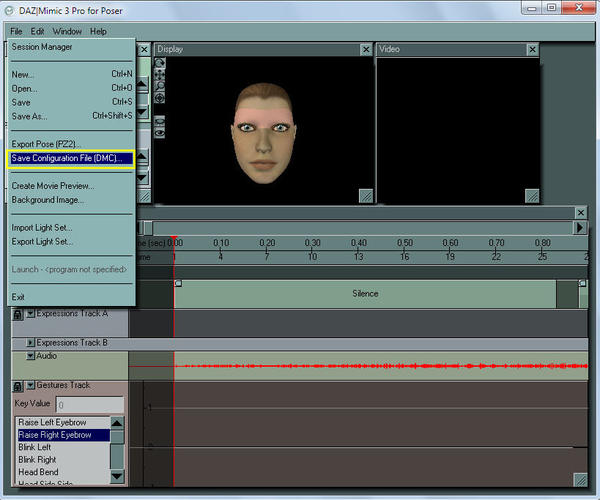

    After creating voice expressions, is there a way of saving them as DMC files?
    I have Mimic Pro, which appears to save DMC files, but for the live of me I can figure out how to use it.
    I believe that the Mimic Pro (stand alone version) pdf manual has good instructions on how this is done - If I remember correctly, you use Mimic to go through each sound and expression and set it up in there. When you've finished (at least for the day), you can export or save the DMC file from the Mimic menu. It's been forever since I've read it. I downloaded the manual years ago to see what you do with it. Impressive software, that!
    In Mimic Pro (stand alone) you should have an option on the FILE menu, to "Save configuration file" (DMC) (see pic)
    This allows you to add or change the morphs used in the Phonemes and visemes to suit your customised Daz3D figure.
    In Mimic for Carrara,. once you set up the poses to be used for vocal sounds, your Carrara Character and it's Mimic settings can be saved as a Scene or as an Object (animated group) and will load with all the mimic settings and NLA poses.
    Hope it helps :)
