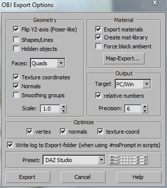

I treid few days ago to create a head morph, in max then export it back to daz via morph loader pro, easy all works well, but when i slide mode the slider its a mess,as it shows in the image i attached i no longer know what to do i dont know what its wrong, my workflow is as follows.

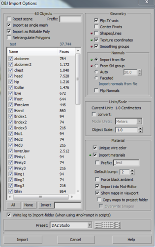

Genesis zeroed base no subD, exported to daz format default settings, then i load it in max under daz settings with out to triangulate it and i leave the scale to 1.0
i make the morph i tryed a bunch of silly ones like wnlarging the head for instance anyway
then i exported back under daz settings scale 1.0 quads no triangulation.
i load it hen back in daz using morph loader pro all is fine but when i try it out nothing works, please someone help, i tried to open it in hexagon then back to daz stil the same result.

    The issue is that the vertex order is being changed. Please post screenshots of the exact import/export settings you are using. Are you doing anything, such as using a resymmetry command, that might change the mesh itself (rather than just the positions of the vertices)?

    be sure to turn off vertex optimization when you export out of max. That fixed it for me.

    But the interesting part is as follows, i just did a genesis base mesh with out touching it inside max then trying to reimport it in daz as a morph just to see if it is a max problem or my morph was bad, anyway, i used the setings as in th posted shots, and it will still blow up the mesh
    @larsmidnatt i have tried that too, still same rsult even with the untouched unmodified mesh, i simply domnt understand whats wrong

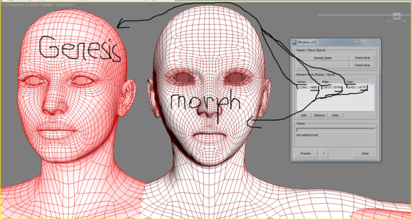

    Well, for those of you ever wanting to do a morph in max DO NOT delete half of Genesis mesh to work on one half then add the symmery modifier, because there is no workaround to repair the mesh vertice, edge, face order. back the one Genesis base mesh has.
    From the link that Richard posted only one script could have worked for me the oher one no
    And its the Morphix one.
    In the attached images you can see that i tried to repair the morph head i made but with no success.
    the difference in verts edge faces is quite huge.
    Well next time i'll know what to do

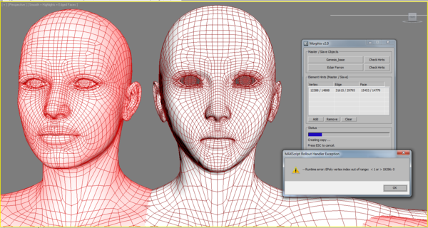

    and then when i try to process it gives that error that i relly dont undesrtand
    and in the third is the actual result of that script and you can see on the left of the mesh the morph which is messy, and on the right of the mesh the genesis side untouched.

    Even if i just export Genesis as base no subD in daz settings default, and import it in max under daz settings, as editable poly and single mesh, i do not touch it what so ever, then i export it back to daz settings default, then i load it back in daz using morph loader pro which has no issue with it, it will still blow up the mesh as soon as i move the slider.

    Out of interest, how are you importing the mesh? As an object or a morph target? I've noticed a few small curios when exporting from Daz to 3DS Max though I've had little trouble going the other way around. It appears as though the vertex order is getting messed up somewhere along the way. Have you tried exporting and importing without using optimization?
