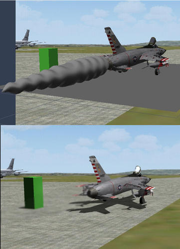

Hello,
I'm currently working on a project where I am showing jets going down a taxi way. I am writing to ask if anyone might have any suggestions on how I might create the effect of the jet exhaust coming out the back of the engine.
The attached image was made in Photoshop. I was looking for a way to have an animated effect.
Should I be looking for a particle system or something done in post-production?
Thanks in advance.

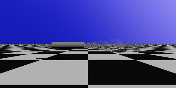

    this is a simple effect, done in bryce, should be duplicatable in Carrara
    two cones, fully transparent, with a turbulence bump and displacement applied, Refraction is 101 for both cones (100 in bryce is air)

    Here's a quick WIP image showing what I've got so far. I made an polygon object for the exhaust and applied a wave deformer to it.
    I haven't quite figured out how to animate the deformer to make the shape "ripple"
    From the effects menu for the shape I enabled the blur object effect.
    The material was started with a preset material - transparency 1 -
    I'll have to read up on how to make and apply animated textures to the exhaust shape
    Thanks to everyone for their suggestions. They've been quite helpful.
    For the wave deformer, you should be able to change the parameters over time. I'll see if I can come up with an example.
    The same for the shaders. The extremely short answer to animating shaders is that if there are sliders, you should be able to adjust those over time as well. Just to emphasize, there are many, many other ways to animate shaders besides sliders. They're just the most obvious if your new to the shading room.

  • J MacKayJ MacKay Posts: 0
    For these taxi scenes an afterburner effect isn't required.
    Here's the scene with engine effect that I think works best. The key was making an animated texture for the alpha channel that included a fade out to 100 black on the left side of the texture. That way the exhaust shape faded to nothing at it's end. Another key was adding a blur to the shape in the effects menu. I like the way the exhaust blurs the front of the jet that's following it. I briefly played with a particle system, but it required a huge amount of render time and I really didn't test it out since the animated alpha texture seemed to do the trick.
    https://vimeo.com/56505122
    In working on animating the wave deformation - the wave seemed to start in the middle of the shape and work it's way out toward the ends. I couldn't see a way of changing the orientation of the wave. I clicked on the buttons for the different axis, but the effect didn't seem to change. It might make a difference how the shape was oriented when the deform wave was applied.
