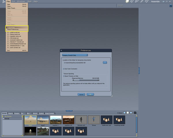

    you can access and reset your preferences from the FILE menu (see pic)
    You can also set up a different location for Carrara's Scratch disk and temporary files, and that should resolve any issues with your SSD and Cache software.

    OOps ,.. I forgot to post the pic of the prefs options,...
    If Carrara is crashing with or without the SSD cache software installed, then you need to get that problem figured out first before you experiment more with the SSD
    You shouldn't move any folders from Appdata, it's a windows system folder, and having read the OCZ stuff, if the preferences files was an important file, then it would be moved to the SSD by the dataplex software.
    I can't see how the preferences file would cause any issues,. but I can see a possibility for the Carrara cache (temp) folder and scratchdisk to be an issue, since this would be the most frequently written (hottest) files while using carrara.
    and any attempts to Move the temp folder while the application is running would cause issues.
    You could try setting the temp folder to the SSD , then restart carrara
