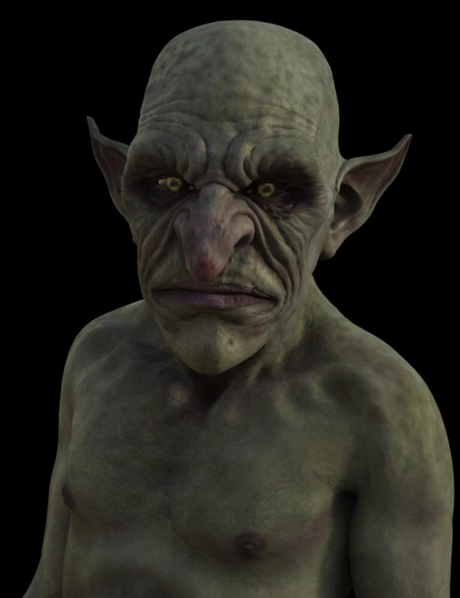

  • Josh CrockettJosh Crockett Posts: 572
    edited January 2017
    Also, to become a PA is not all that difficult, just create a character, prop, environment... whatever you're best at, and submit it here: http://daz3d.com/community/community-publishing
    And trust me, HD is not the only option you have.
    I created this character with base resolution morphing and scaling and normal maps: Removed Off-Site Commercial link
    To further prove my point, here are some shots of my latest HD Goblin character
    The first one is normal map only, and the one on the right is a level 3 HD morph only
    The difference is very subtle
    I would encourage you to grow your skills as an artist, and prove that you can do a low poly model with normal maps first, submit it to DAZ and become a PA yourself :)
    665 x 865 - 225K
    665 x 865 - 223K
    Post edited by Chohole on
