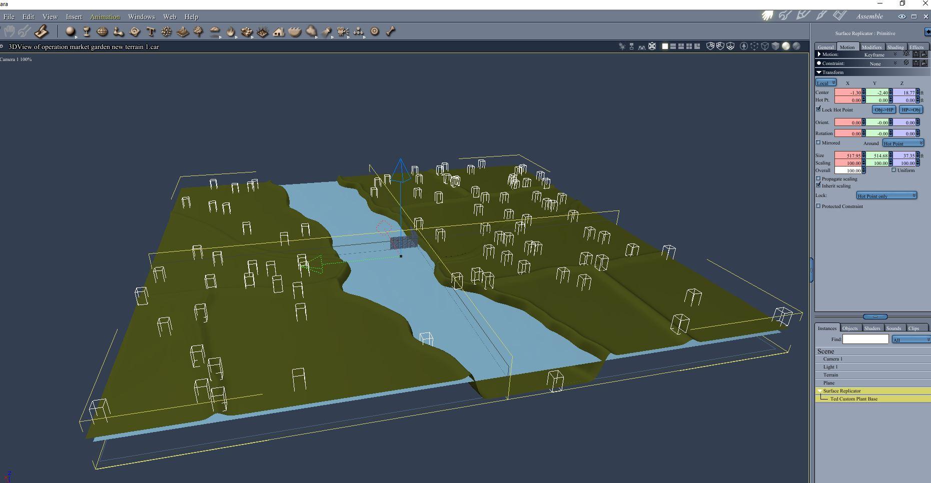

Aaargh.  I created a terrain.  I created some opacity masks.  I inserted a plant.  I inserted a surface relicator.  I limited the replication to the shader.  I used the opacity mask that I created.  The replicator is not limiting the distribution to the map.  I have tried jpg and tif file format.  I have tried simply using the maps in the color channel.  I have tried using a black and white mixer in the color channel and then using the map as the blender.  The plant is being replicated over the whole terrain.
Hmmmm.

    Thanks for the reply - nothing is silly that could be the answer.  However, in this case I do have the box checked.  Here are the replicator modeler room settings  Should have included this.  Open to more suggestions.

    I fiddled a bit with your image downloaded from the forum on a terrain and only got a visible result with ticking the objects try to cluster and upping that slider

    i had a quick look at your distribution map,. above,.
    in photoshop it's info say's it's not pure black or white values,.   0, 255
    Black is  RGB 2,2,2, ,. White is RGB: 251, 247,248
    that will probably be throwing out the surface replicator distribution, as there's no true white.
    try this version.
    pic to help
    Also,. for a tight area like this you probably want to increase the quantity or objects ,. just to force it to use all the space.

    yes I think not pure black either as can see by the sparse spread on my terrain

    I started the terrain and surface replicator over.  This time, I made sure that I used pure white and pure black in photoshop for placing the trees.  It worked.
    Thank you!
