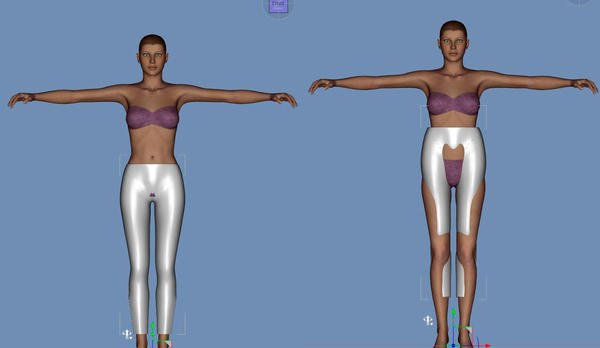

For some reason the figure setup tool seems to change the position of the bones when I try to create a piece of conforming clothing. I am following the same procedure as I did in Studio 4.0: First I zero the V4-Figure, then copy the skeleton to the setup window. After that I add my own geometry. When I create the figure all seems to be okay, as you can see in the left example, but when I fit it to V4 it looks like the right image. All bones have different positions than those of the Donor-figure. Why is that?
To check if I did something wrong I tried to re-create an old piece of clothing that does work well in DS 4.5 as well as in Poser 8. I did everything the same way, added the old geometry, and so on. But this time it produced the same error. All bones are in the wrong position. That's very annoying!
For the new figure I have begun to correct the positions of every single bone manually with the joint editor, but that's tedious. There must be a better solution.

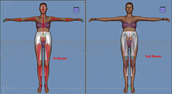

    Anyway I would like to know what's going wrong. I have made new screenshots showing the bones. As you can see they are really out of place. Only the hip-bone is a little bit longer.

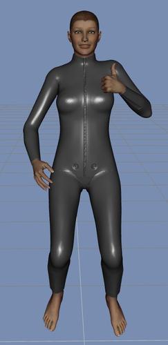

    Oh, I forgot: This is how it should look like! (second screenshot)

    In this instance, it's not a case of scale, but in how the Figure Setup Tools creates the bones...
    The size and position of the bones is determined by the face groups of the mesh... each bone is centered within the area of it's face grouping... and since this does not match up with V4 or whatever other figure, the mesh will shift it's position when conformed based on the position of the hip bones center point, because that is the root node...
    There are a few ways to correct this, one is to manually adjust all of the bones to match the fit-to figures bones...
    The second is to check the box in the Figure Setup Tools that says Modify Selected Figure with V4 selected in the scene... this will retain the correct bone positions, just be sure to rename the figure...
    The third way is to just use the Dev .cr2 and edit the geometry path to your .obj...
    Hope this helps... :)

  • Richard HaseltineRichard Haseltine Posts: 111,898
    If you want to copy the donor skeleton make sure Modify Selected is checked in Figure Setup - if you want to create a new figure then DS will guess where to put the bones based on the bounding boxes of the groups.
