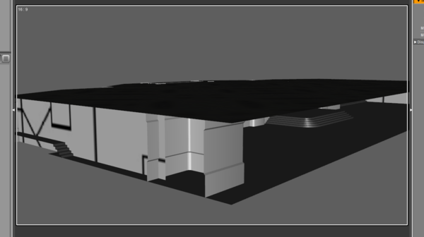

I have returned to using Poser as I recently got the Octane Render plugin for poser pro 2012. I have noticed, and I also see this in Poser Pro [7], that sets that have walls -- Hyperion Bar and A-Deck, so far -- those walls are invisible in the camera preview. The walls will render fine, but when placing the camera, I can't tell if it's inside the wall or inside the room. Is there an option somewhere to disable this feature?

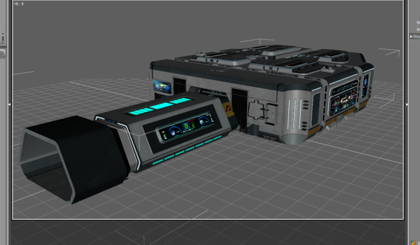

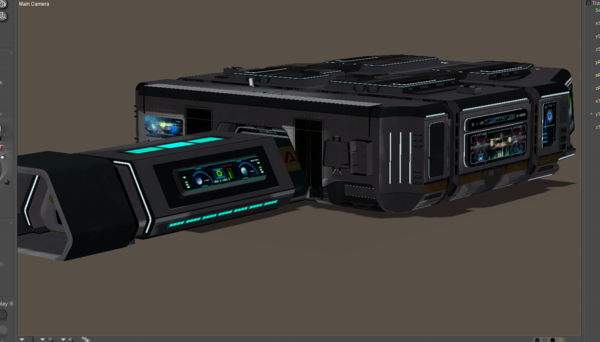

    Attached are screenshots of the two models in DS 4.5 (Hyperion only comes with Poser shaders)

    The polygons that make up the mesh of the figures have a "front" & a "back" face. Poser's preview only sees the "front" of the face whereas DS can see either side. So if the polygons are facing the interior of the figure; Poser won't show them in the preview screen unless the 'front' is pointing toward the camera (as can be seen in your first post). You might try switching to wireframe to set up your scene.
  • wimvdb_dc63ee9ce6wimvdb_dc63ee9ce6 Posts: 183
    there is a setting in the Render settings in the preview tab: Uncheck ":remove backfacing polygons"

    Remove backface polygons is the default setting - so did you change the setting earlier?
    It should solve all the single sided polygon display issues. If that does not help, I have no idea what problem it is. It has always worked for me
  • SupercopeSupercope Posts: 128
    edited December 2012
    :red: I suppose it would help if I looked in the right place for it. Initially, I was seeing it on the Firefly tab and didn't realize there was a Preview tab inside Render settings. Thanks everyone for your invaluable assistance!
