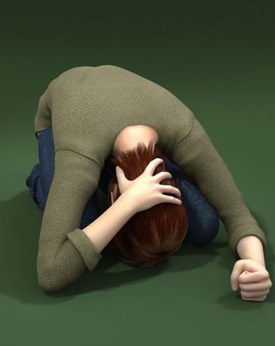

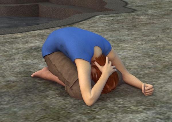

    Might help if I gave an example.
    The first picture is from the promos of the pose.
    The second picture is what happens when I load the figure and apply the pose.

    I can tell you in DS4.5, when I apply that pose I get a dialog box that the pose exceeds the figure's preset posing limits and gives me the option to choose to keep limits on or off.
    If I choose:
    Turn limits OFF, Justin looks like the colored picture.
    Keep limits ON, he looks like your problem image.

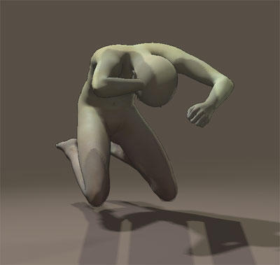

    Yeah, I thought that's what it might be. But the limits appear to be off by default on the Genesis figure in Poser 2012. When I turn them on, the scale of the figure gets set to 0%, and when I scale it up to 2500% and zoom in, just to see it, it's completely distorted.
    I'm not sure what's going on.

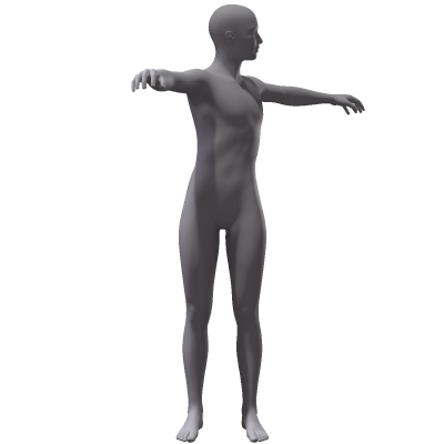

    Meanwhile, in the real world this sounds like a job for a Python script. Because computers are designed to be good at repetitive tasks like working through all the body parts of a figure, leaving human beings to be creative. So there's now one at:
    www.who3d.com/downloads/NoLimits.zip
    This is not limited to any particular figure, or indeed even to DSON figures. There is no warranty of any sort. If anything goes wrong, I'll refund you exactly what you paid for it :)
    Please give people the link rather than the file, so they get it from me :)
    Cheers,
    Cliff
    PS I've tested it, but not much. Consider yourself a beta tester if you like - and let me know if you have any problems. Yes - there's even a readme file!

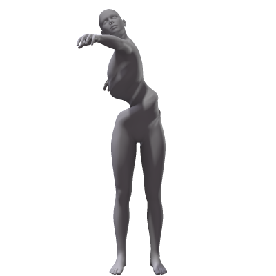

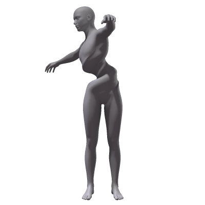

    Sadly, I found a situation under which the script wouldn't work. So I've made it a bit more robust for vesion 0.3, and added a "ForceLimits" script to turn limits on again. So you can switch back and forth between limited and unlimited and the poor figure will prance about like it's got ants in its pants :(
    Same link. Check the readme - if it doesn't say it's v0.3 then you've downloaded a cached version somehow.
