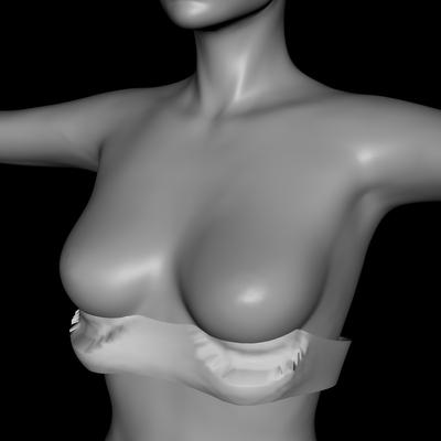

okay, so I made this Bikini Top
http://www.ShareCG.com/v/66421/view/5/3D-Model/wc-bikini-top-obh
That's the raw OBJ.
I imported into DS. It's DAZ Studio Scale, by the way.
I called up Genesis
I shaped Genesis to Victoria 5
I selected the top
I selected the Transfer Utility (Edit, Object, Transfer Utility)
Source Item: Genesis
Item Shape: Morph: Victoria 5
Scene Item: WC Bikini Top
Projection Template: Shirt
Reverse Source Shape from Target is Checked
Fit to source figure
and I get this:
400 x 400 - 37K
  • adaceyadacey Posts: 186
    Apparently your genesis figure is on spring break :D
    Don't use shirt...use bodysuit (tight).
    But did you model it to the base Genesis?
  • niccipbniccipb Posts: 483
    Hi...
    That kind of looks like it might be a scale issue...
    Did you set V5 to 100% scale in DS before you exported out to .obj for use in your modeler?
    If you didn't, then when you run it through the Transfer Utility is will compound the scale of the source figure...
    nicci... :)
  • BejaymacBejaymac Posts: 2,012
    A little tip, always model around the default Genesis shape and never around a morphed shape, saves you a lot of grief later.
  • kitakoredazkitakoredaz Posts: 3,526
    it must be scale issue. when you use transfer utility with Item shape (morph) option,
    you may need to check first the morph change genesis root node scale or not.
    if when you apply the morph, the figure change root node scale ,
    as nicci said, you need first change the figure scale to "100%".
    with the obj parented the root node of genesis.
    it means you need to adjust the obj shape V5 shape 100% genesis scale.
    sometimes you may need adjust the obj positon for V5 100 scale shape too.
    then export it as obj, and reimport again.
    select the improt obj as target then use transfer utilty as same as before.
    it is same when you use A3 shape for genesis morph. with transfer utility option.
    on the other hand, clone shape not change rig scale and move rig . It has no sub components.
    so when use transfer utility ,if you have clone shape, or you make the shape morph which not change rig scale,
    (maybe it can be called clone shape) just move vertices and change the size of figure.
    you can use it as transfer option. they have no scale issue.
  • wancowwancow Posts: 2,708
    Okay.... list:
    I built it around Victoria 5, which I thought Bobbie25 did regularly... so scale...
    Yah, I understand about Default Genesis... I think I'm going to try to build stuff around that first from now on...
    Body Suit... I'll try that too...
    kitakoredaz, I'lll try your method first.
