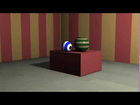

    Great... Things have worked out fairly well so far... ready to shove big Greenie ball off cube... after adding a bunch of keyframes which I'll need to adjust for timing, they are all crammed into 4 secs.  I'm hoping I can just plop in a keyframe in between others and make adjustments if needed.  Also haven't added any morphs and hope that I can just add them to object at start and they will be available throughout the anim.  Last thing, if there is time, I want to mess with some shaders on stationary objects... hope you don't mind. :)
    A problem I did have last night was with trying to turn the Spin modifier off at the correct spot. I'd moved and spun it, the blue ball, to a certain position... looking up at what the Time was I entered that setting for it to turn off. Unfortunately it stopped before the keyframe so had to mess with revs per second as well as seconds in order to get it to stop at the correct location.
    Also before starting I set up a SoftBody modifier and have "use collision detection" on. I'm sure that I need some practice with Softbody settings since I've not seen any benefit in adding that... yet.
    Luckily I bought Phil Wilke's, PhilW, Animation in Carrara Video Tutorials so will likely learn a lot from it.

     wgdjohn,
      It is your animation you can change what every you want with the shaders.
    The spin modifier is a little confusing.  For figuring out the Start and Stop times enter values that are a percent instead of frame number.  Lets say your annimation is set to 24 fps and you look at your timeline and decide to stop  your Spin modifier at 1:06(1sec , 6 frame), if you input 1.06 into the modifier stop time it wont stop where you want.  If you enter a percentage instead , the 6th frame of 24frames in percentage terms is 6/24 or 1/4 or 0.25 . So, entering 1.25 in the Stop time should get what you want.
    Look forward to seeing your animation.

    Mike, I'm nearly done... here is what I have so far in the scene file.  Still have a bit of tiny adjustments to do. Want to:
    • Have Green ball squish a little when it bounces on floor.
    • Show exictment of Blue ball when Green ball falls off.
    • Review and adjust any timing... I've notice a few.
    Is there an easy way to copy a keyframe?  I've been moving the scrubber and then moving the object and setting any Motion setting back to the previous keyframe... a bit of a bother but gets the job done.
    Oh great... I saved/closed and re-opened the file and all the motion for the Green ball is now gone. I've no idea what the zip below contains... should have Green ball hitting the floor and bouncing off screen... will have to check tomorrow... don't even want to open any earlier versions and have mess them up.
    Hope I have time to play with a few shader settings... don't think I'll get to any morphs for this one.

  • PhilWPhilW Posts: 5,162
    You can copy an existing keyframe by using Alt-Drag on an existing key, I use it all the time.  And if you just need a bit of squash and stretch, you can use the scaling tool rather than making morphs.
    Your keyframing should be saved with the scene, it is very odd that the motion has disappeared.

    Phil... Thanks, that will save a huge amount of time. Will that little plus sign go away or remain to mark any keyframes added with Alt-Drag?  I've barely started on your Animation tutorial... will eventually get back to it.
    diomede... was thinking you might be lurking in the shadows. :)  Your squish certainly looks better than mine... perhaps I over inflated my balls.
    Mike... Doh! .. Thanks for pointing that out... don't remember unchecking it.  Thanks also for complimenting my motion... means a lot to me. blush
    I've got the Green ball offscreen in 7secs... now I can work on Little Blue again... I'm wanting to create Blue's excitement and have a quick fade to black... going to see if light settings can be changed for the latter... if not I'll add a plane with invisible shader and use that for the fade out at end.
    When you Alt-Drag a keyframe it just produces another keyframe, it is not linked to the first one. When you say "little plus sign", I think you may have two keys that are very close together and that is almost always not a good thing! If you zoom into the timeline, you should be able to see more clearly, and if one was set by accident then just delete the unwanted key.
  • wgdjohnwgdjohn Posts: 2,634
    That explains why when I drag the one with the plus sign there was another under it... musta got carried away trying to create a copy.

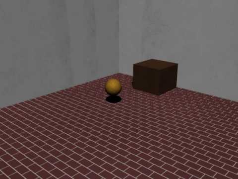

  • DUDUDUDU Posts: 1,945
    We had this kind of exercice a few years ago on Carrarators, my first idea was to try the physic engine to do that and I have seen very quickly that that was a crazy idea!
    The graph editor was the best solution for this challenge...
    http://www.bond3d.byethost18.com/index.php?topic=22.msg110#msg110

    By Golly... I might be done. Check HERE or Below and see what you think.  I'm open to criticism.  You might notice what appears like a wood texture on the right hand wall near the corner... there is none... I suspect that it is reflections off the reflective cube in the scene.
    Post edited by wgdjohn on
    Dudu,  I like very much how you had a reflective wall to make it appear as if he knocing ball to someone else. You definitly have character animation licked... while I struggle to work on a simple static pose.

    Why thanks... I even impressed myself a bit... especially since it's been 4+ years since I last animated anything.
    Note to All:  The AVI player in the Carrara's Render room is messed up, at least for me.  I set it to loop and hit Play button... each time it looped a different unwanted result showed.  It also didn't play properly with loop off.  I closed the player window and opened the file with a different Player and everything was fine... what a relief that was.
