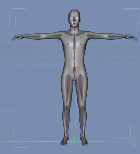

    I think Daz missed out on a great opportunity when designing Tri-Ax rigging. They really should have taken that opportunity to get away from the laborious Poser group system and done what every other application, including Carrara does, to simply draw in bones.
    What do you mean with bones? Studio uses bones too, but I don't know if those are the ones you mean though (see pic).
    As for the grouping, it happens automatically now (at least for clothing, haven't tried other things)
    But complex models still gonna take a lot of time and effort :D
