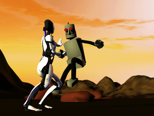

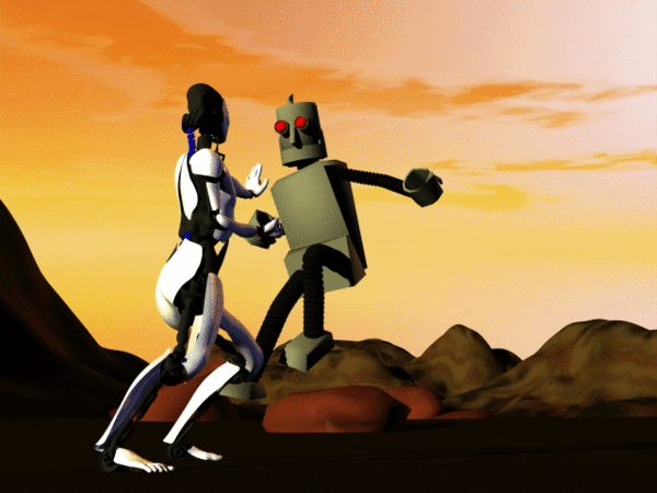

I've been experimenting with stereoscopic .gif rendering which produces an illusion of 3 dimensions on a 2 dimensional screen. It's not too hard and I seem to have discovered a technique that works pretty well.
First compose you image with the focal point in the centre of the screen. Then set your camera's Point At to the centre of the centre object.
Render the image then pan the camera a few degrees to the right or left and render the image again. Then use whatever animated gif software you use to make a looped animated gif using the two images as the two frames with a frame rate of .1 seconds each. Too fast and the image will just be a blur, too slow and the optical illusion won`t work.
If the over all scenery is what you want as your focal point then don`t pan the camera too much. This will make the over all image appear in 3D without too much image shake but the centre object of the image will appear flat.
If the centre object is your focal point then pan the camera more. This will make the centre object appear more 3D but the scenery will have more image shake.
Anybody else have any techniques or tips on this subject they'd like to share?
