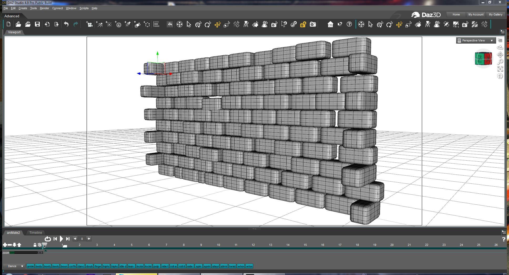

    and so I start building ......
    1936 x 1048 - 330K
    398 x 224 - 28K

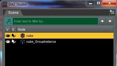

  • I have hit a brick wall though pardon the pun, I found I cannot instance instances ...
    I am used to Carrara and replicators where I can replicate replications though D|S has the advantage of manual placement
    so it seems I need to build this .....wait for it ..... one brick at a time ><
