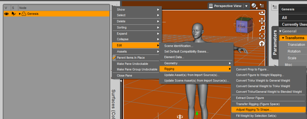

    it looks like what happens in this pose: http://ic.pics.livejournal.com/portisheart/20215082/139935/139935_900.jpg is that the morphs have moved the geometry away from the joints, and therefor the joints need adjustment...
    There are threads on how to do that. I haven't tried yet.
  • Tramp GraphicsTramp Graphics Posts: 2,433
    I agree with Wancow, though I've never seen the Die Trying morphs do that to a figure before.
    Is this what you're referring to?
    1000 x 389 - 129K
  • manekiNekomanekiNeko Posts: 1,456
    i haven't seen any complaints on the DL page either, and they seem pretty savvy in their awesome work in general. i think using "contradictory" morphs like (too) thin + athletic/bodybuilder, where one pumps the body up and the other contracts it, might not be the best idea.. might happen with other morphs created by other people too.. if only i found a free "6-pack" (abs) morph, i could give up the extreme mix..
    i tried this edit - no change in this pose..
    under EDIT-GEOMETRY i found "apply push modifier" - gets rid of the too thin.. and transforms my genesis into some puffed up Michelin man :(
    yes, i'll have to search further for "threads to do this". it's what brought me here actually - in the wrong thread ^^
    or/and i'll have to bother Sickle again i guess, must be tiresome if i ask stuff after every third DL from them :red:

    Try it and see if it works. The contradictory morphs may or may not be the issue, but I can tell you none of the available bend fixes will do anything for that knee problem below a certain diameter (just as they won't for S5 Model Body when they're made for V5). Adjusting the bones, freezing the ERC and saving back to library might. I didn't actually know how to do that, or that these things could come up, when I did the original conversion of DieTrying's work.
    edited March 2013
    so sorry - i didn't get the notification for your answer, SickleYield.. (does that happen for the same reason pm's didn't work on a couple of days??) ~ hence i thought the point was moot..
    RL being a bit rough + a contest taking my focus, i didn't busy myself with this problem again until now, to check on what people had said. because i haven't found any joint/bend/fixes for genesis legs either, except for "beautiful legs" and "V4 poses corrections for genesis", which don't seem to apply here (gun pose is made for genesis, and the beautiful corrections seem to be for minor displacements).
    i tried the edit-adjust rigging to shape mentioned above, and saw no difference whatsoever. i tried as the figure was in standard pose, i tried as it was in this gun pose - no difference. i even tried fumbling directly with the pelvis (this seems to be too low) to raise it (and the rest of the body above it) higher, but even i pinned the feet, the knees, the ik chain was too complex and everything still moved up chaotically. raising the hip ditto. i'm really no ik specialist ~
    i think i will just avoid using this kind of extremely bent poses - at least until i can handle daz better.. there are so many other things to discover. and finally, a new prepaid ccard came out so i will be able to access low-cost paid items too ^_^
    thanx for your answer anyway!
